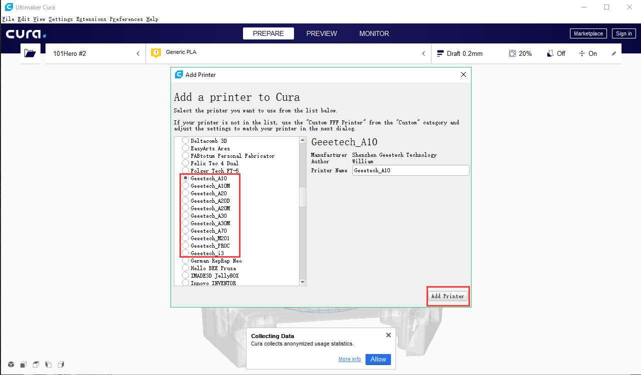

Are you can't find Geeetech A20M on Cura?
Don't worry
Refer to these:

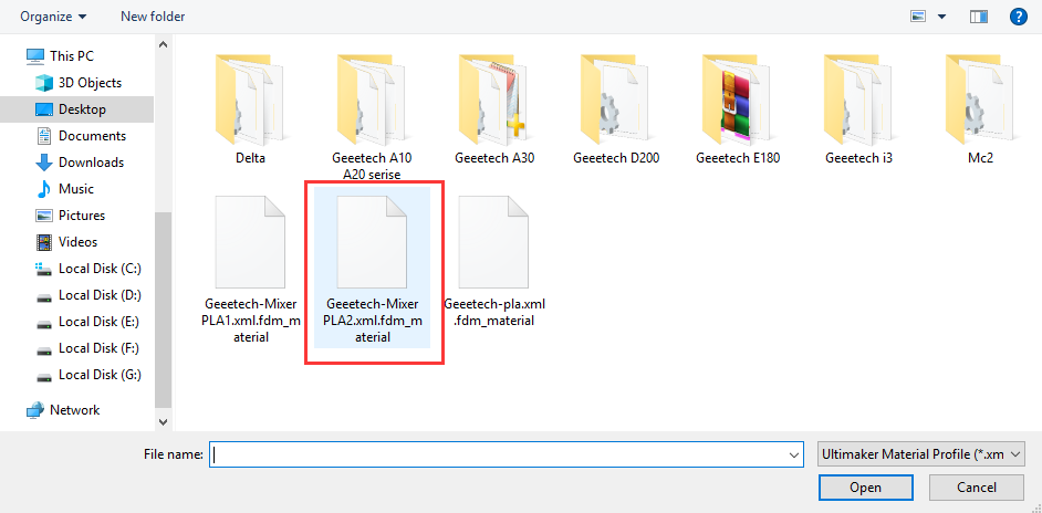

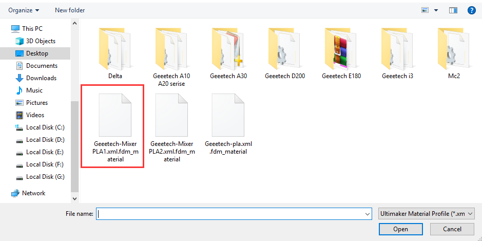

Download the PLA filament profile for A10M
Geeetech Mixer PLA Profile For Cura.zip
(1.82 KiB) Downloaded 5898 times

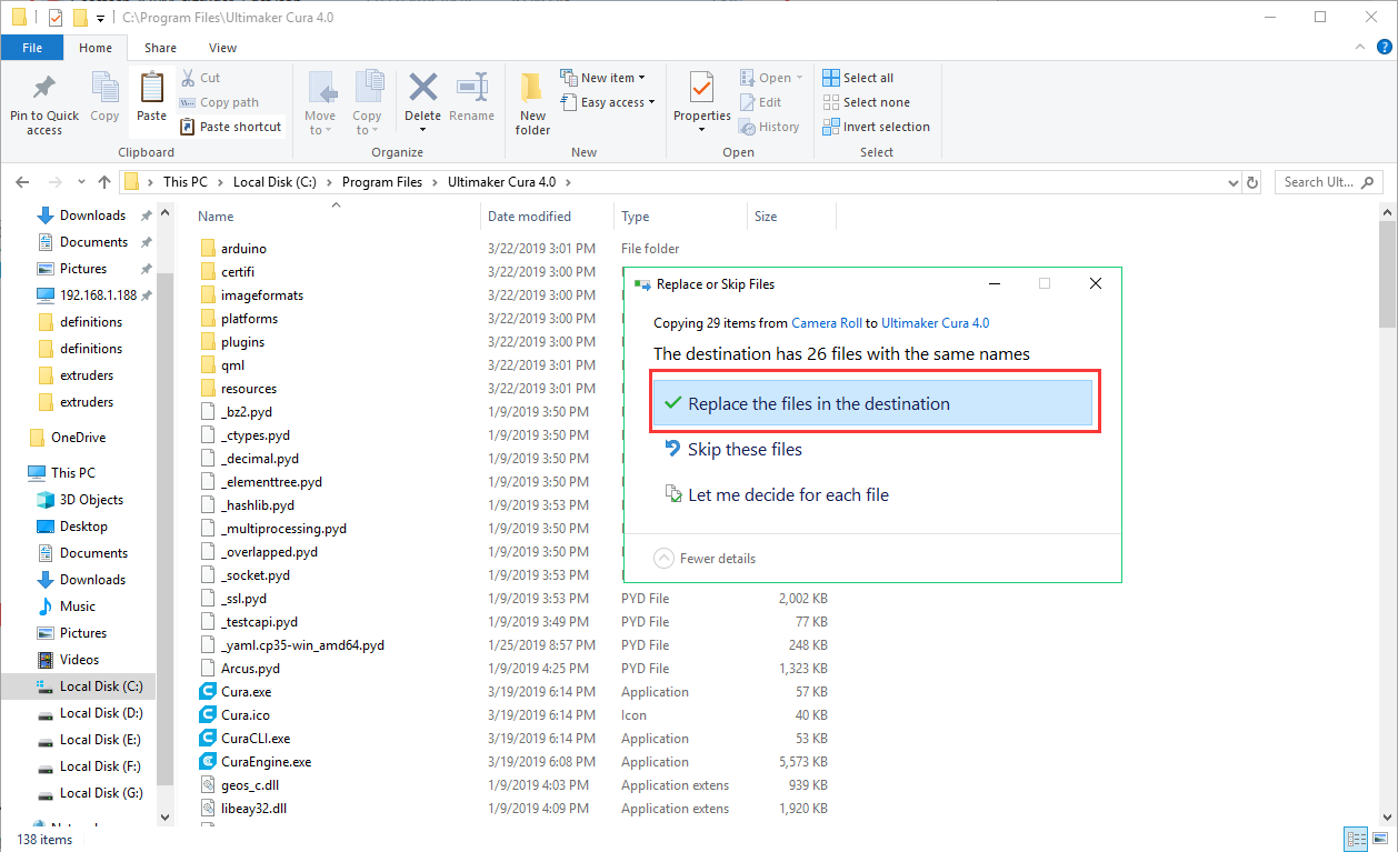

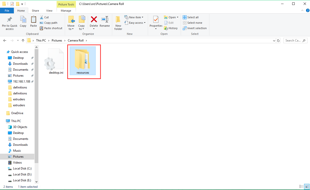

2. Unzip the zip file then you will get "resources"folder

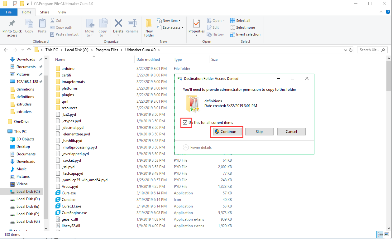

3.Copy "resources" to the
Cura installation directory
Default:
C:\Program Files\Ultimaker Cura 4.0
3.Import the PLA filament profile for Geeetech A10M
Filament profile1.png (29.2 KiB) Viewed 187811 times
Filament profile2.png (48.1 KiB) Viewed 187811 times
Filament profile3.png (49.75 KiB) Viewed 187811 times

Hello,
after installing profile on Cura v3.6.0 for Mac, Extruders appear with incorrect filament size. It shows 2.8mm instead of 1.75m so you need to manually correct both extruders.
