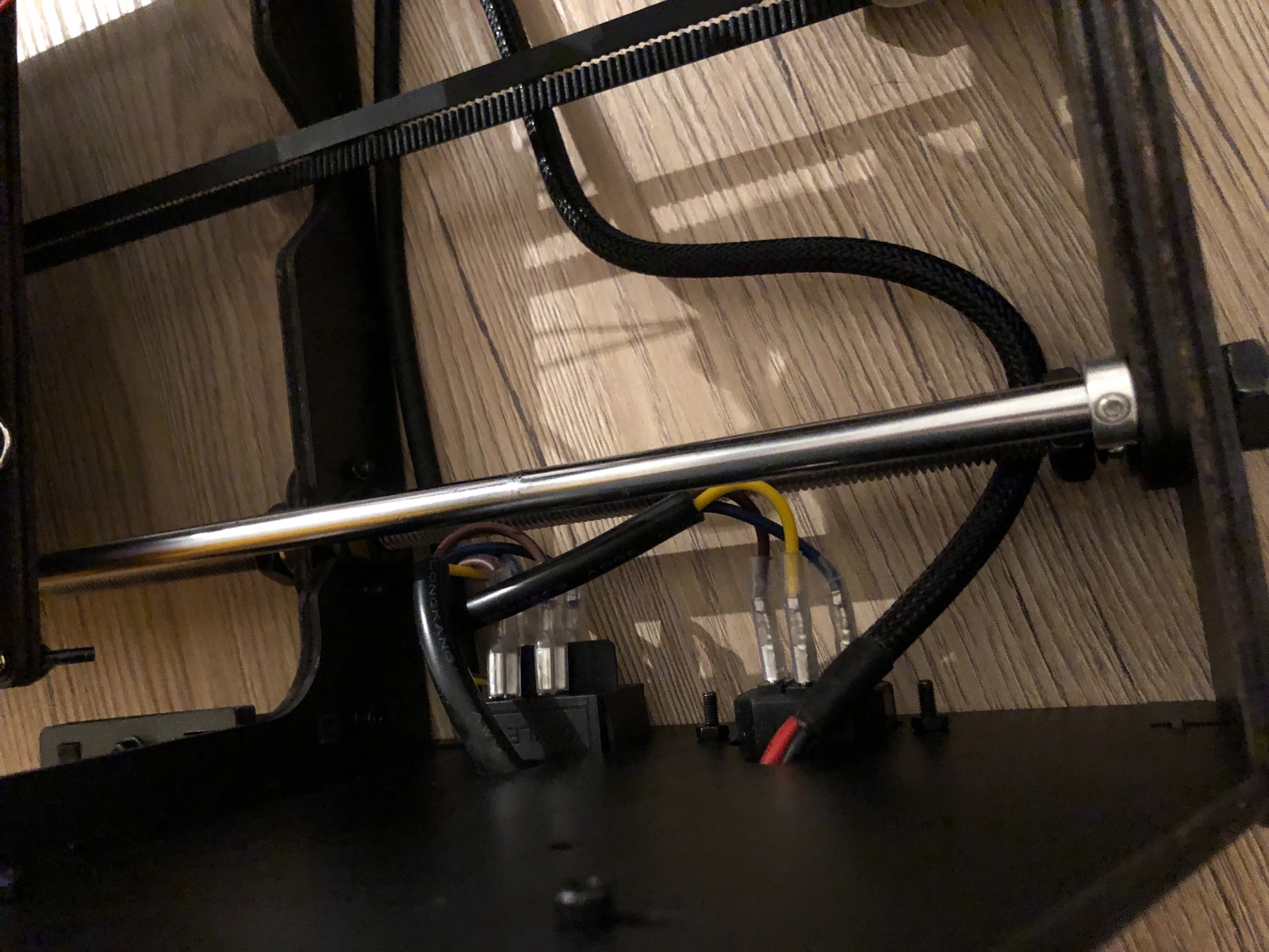

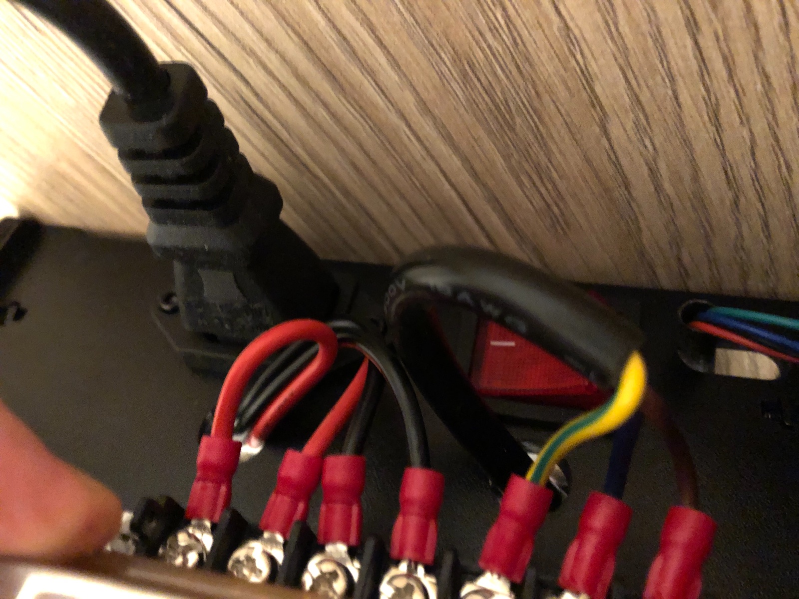

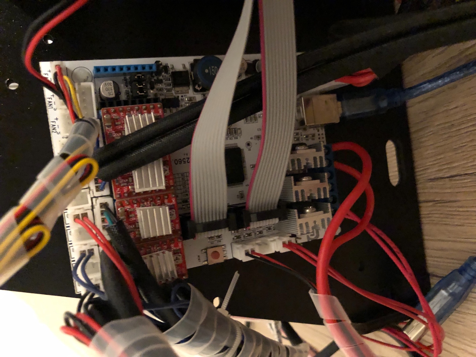

I'll also ask you to post a photo with a view of how you've connected all the wires, not just the power supply. :idea:

Just posted some pics, if it‘s not visible enough, I‘ll post a a new one with description. :)
