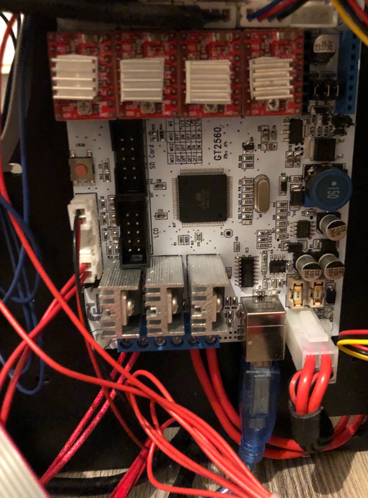

As for the Power Plates, I only know it‘s a GT2560..
I‘m leaving a picture as an attachment, maybe you‘ll know.(hopefully)

Your controller board is GT2560 rev A+.
You have presented the description in detail, it's good.
Unfortunately, the fault does not seem to be light. :roll:
No communication via USB, and no control for the stepstick modules can be a sign that the main µC is dead. :(
