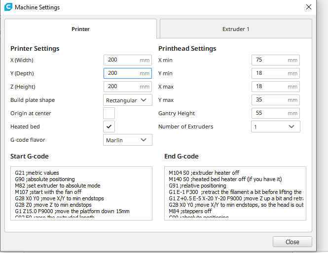

Just so we are clear, I do not want to use reptier it will not work, it keeps sending reset commands to the printer, No to be all cocky but IT is my career for the last 30 years so I do understand com ports etc.
Cura is set up and working fine, so we know it isnt a com port issue dont we.
I thought you was refering to the some Gcode i had written. I think there may be a language barrier issue..
I am unable to copy in the Gcode as it is too long.

Now, looking at the tall stringy mass that should have been a calibration cat thing, it looks like the z axis is so far out I would suspect that you have upgraded T8 lead screws rather than plain M8 x 1.25 rod.
The T8's require a mod in the config'.h file as their pitch is 8mm not 1.25mm.
Default axis steps... change 2560 (M8 rod version) to 400 (T8 leadscrew version)
What leadscrews are you using ?

Hi Gerry
Many thanks for the reply,
Yes i agree it was getting a little complcated lets say :)
What you say does makes sense from an engineering poit of view and as i was trying to get across it move on the z plane far more than the .3 that i was expecting.
Unfortunatley, i havent changed anything, it is completley stock, straight from the box. It is definatley is T8 not M8.
I can imagine it being M8 it would be soooo Slow moving along the axis.
Anyway i have sent 2 Gcode commands over and voila it is printing. Awesome buddy
Many thanks indeed
