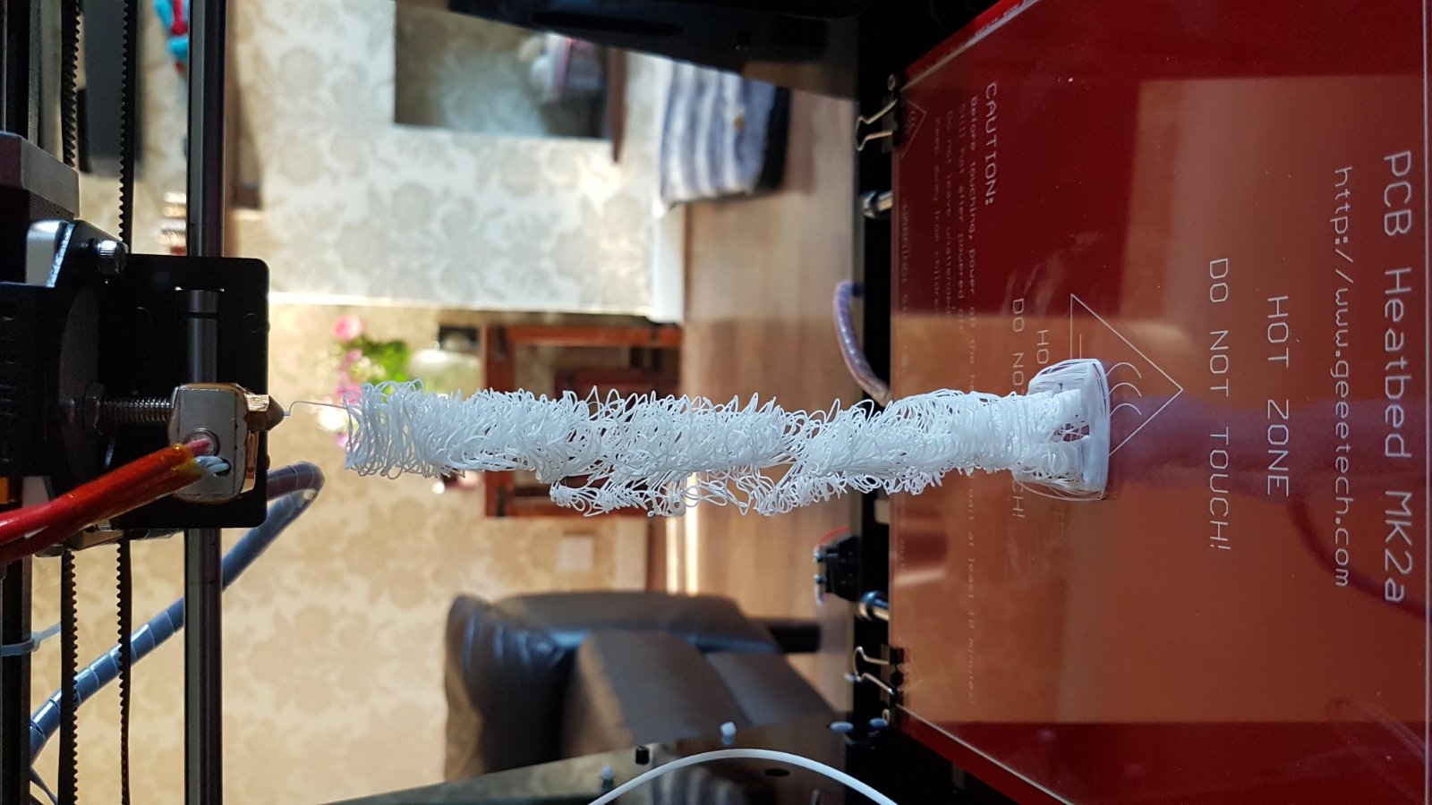

So I attempted to print this
But i got this
Many thanks
But i got this
Many thanks
Paul
Hi, From your printed results, you need to level the hotbed.
It seems that the distance between the nozzle and the hotbed is a bit far.
You can try to adjust it to the right position and print again.

I have already levelled the four corners so that there is 0.05mm gap using feeler guages.
The centre of the bed is very warped so I mounted a spring in the centre, it now is also 0.05mm so it cannot be the level of the bed.
When it prints it steps a lot higher than the width of the molten filament

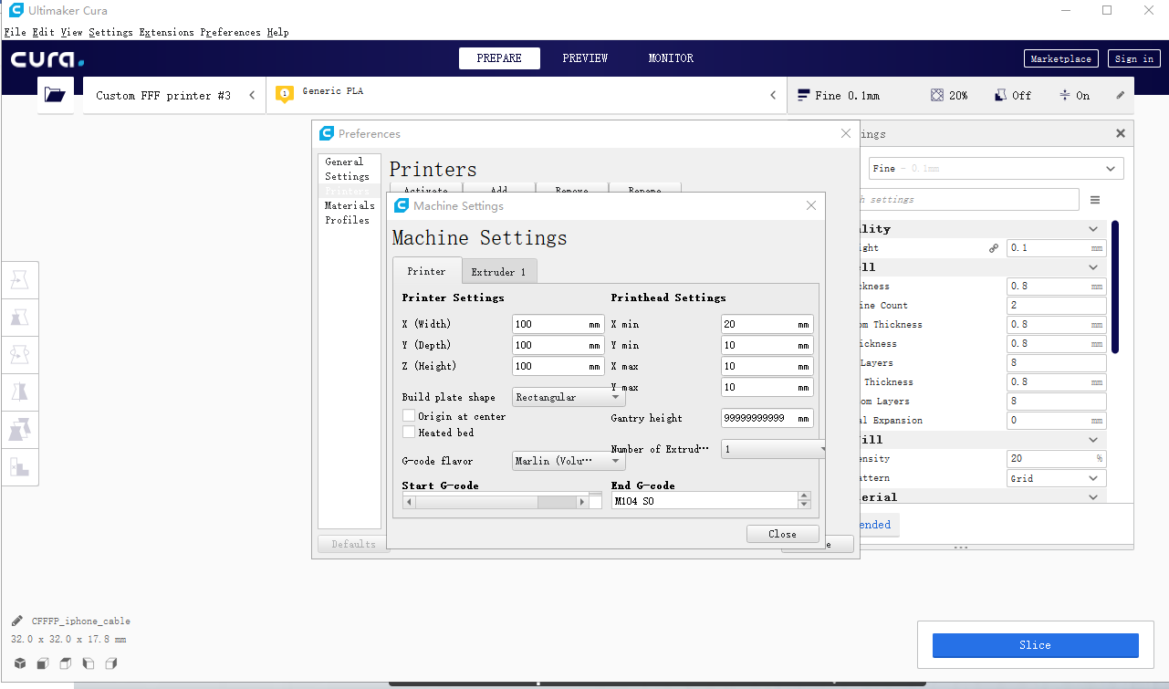

Hi, If you insist on using Repetier Host,
you can re-install the download and select the correct serial port and baud rate to connect the printer.
I told you that you can use Cura if you can't use Repetier Host.
You need to set up the printer and print the configuration, such as:

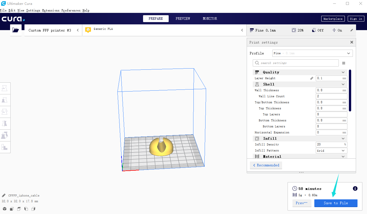

Gcode is the file you generated after slicing the model. You can refer to this:
gcode 保存.png (99.26 KiB) Viewed 7733 times
