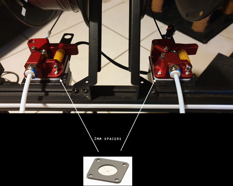

Steppers motors protectors (aka TL smoother) does not help, extruders still stop when printing with linear advance enabled.
Setting extruders TMC2208 in SpreadCycle mode via OTP works ! and they are not a lot noisier, perfect !
Also I have upgrade both extruder with dual geared one (original CR10S-PRO extruder), extrusion is now really really nice and reliable.
A good thing is that dual gear extruders (CR10S pro original) are compatible with the A20M and only requiere 2mm spacer (stl model attached to this post).
For those extruders in Marlin, set 140 step/mm.
The only downside is that those extruders are not really cheap...

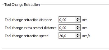

Also, you MUST set "Tool change retraction distance" to 0 (disabled) in the "Other" tab
