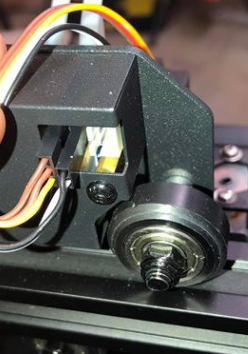

:D Hi, The specific insertion method is 3pin brown wire on, 2pin black wire on.
you can refer to this:
3d touch接线参考.png (140.09 KiB) Viewed 26695 times

orange on top and black on top is the working config
