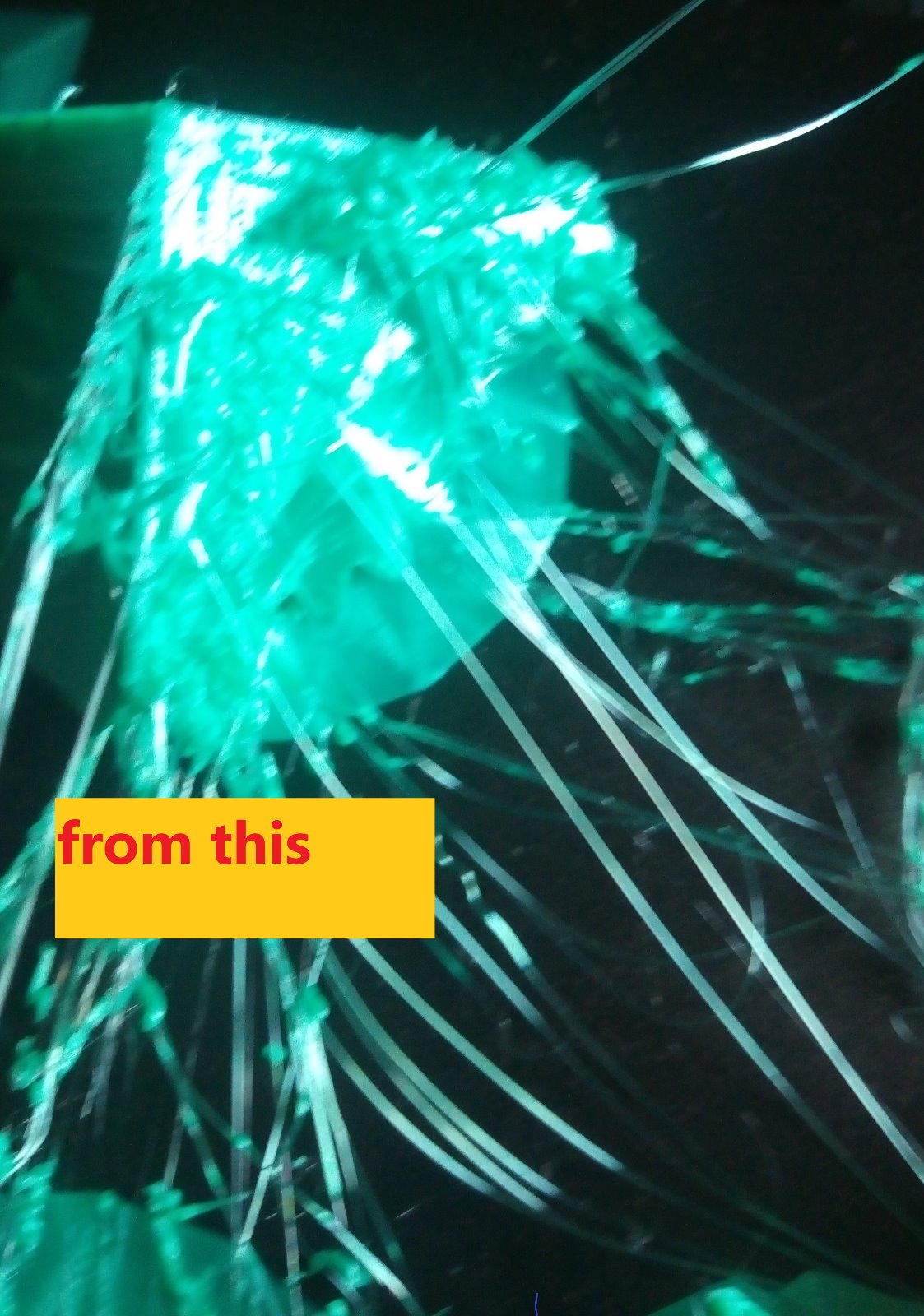

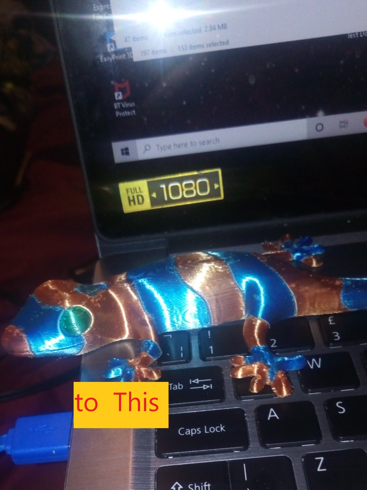

hi if your using cura you can select the individual extruders you wish to print a model from and also set up multi colour prints even as far as setting up virtual extruders for mixing the colours ive just set one up with 8 individual colours 3 of the standard extruders then 5 mixed from the other 3 ive learnt every thing by following the videos of 1zradio you tube channel https://www.youtube.com/channel/UCo2rzw ... 5vBHdQED2A
he talks you through the whole process my prints were horrific but I followed his 3 or 4 videos and wow the difference is amazing my printing has gone from total dejection to actually amazement of what they are capable of in hours honestly I couldn't sing his praises enough
I hope this helps you as much as it did me
oh and he has instruct videos on other slicers too

printing horror show
Re: printing horror show
- to .jpg (215.62 KiB) Viewed 10359 times
here is my cura profile that works well for me
I know there not perfect by any stretch of imagination but compared to what I started with well its def woo hoo time and hopefully some one can improve on them and point me in the right direction
