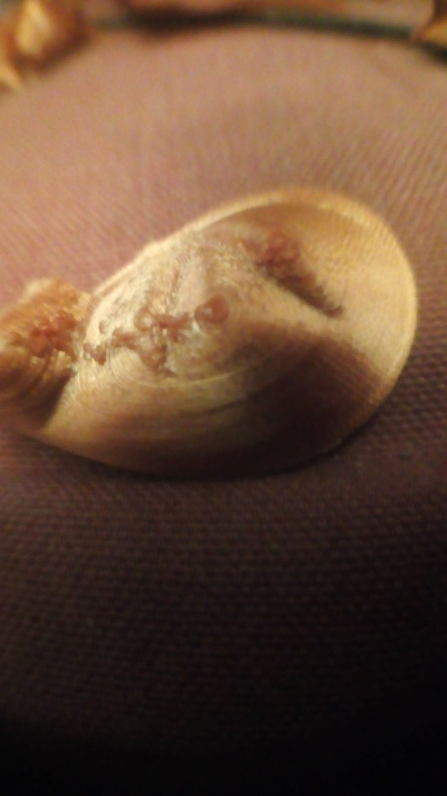

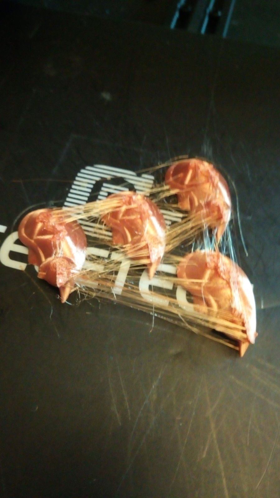

im having some trouble with my A20T ive tried to print multiple items now and even with cura a2ot profile from the downloads but im still having problems with zits and stringing here are some pics to show I have set my retract up to 10mm and tried various temps it has to be said my first print I did off the sd card that came with the printer was so so crisp it was amazing but since then well

sorry pics didn't go on ill try here as you can see its horrible
- cube gear1.jpg (232.17 KiB) Viewed 17786 times
- sml cat1.jpg (103.42 KiB) Viewed 17786 times
- multiple cats1.jpg (144.24 KiB) Viewed 17786 times

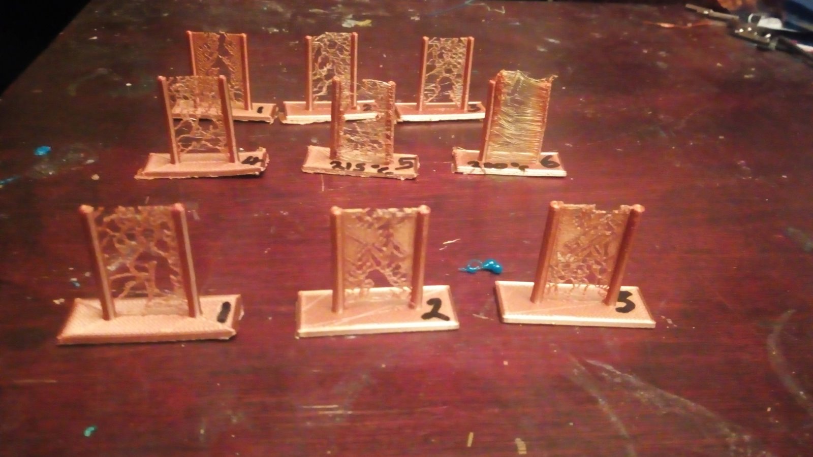

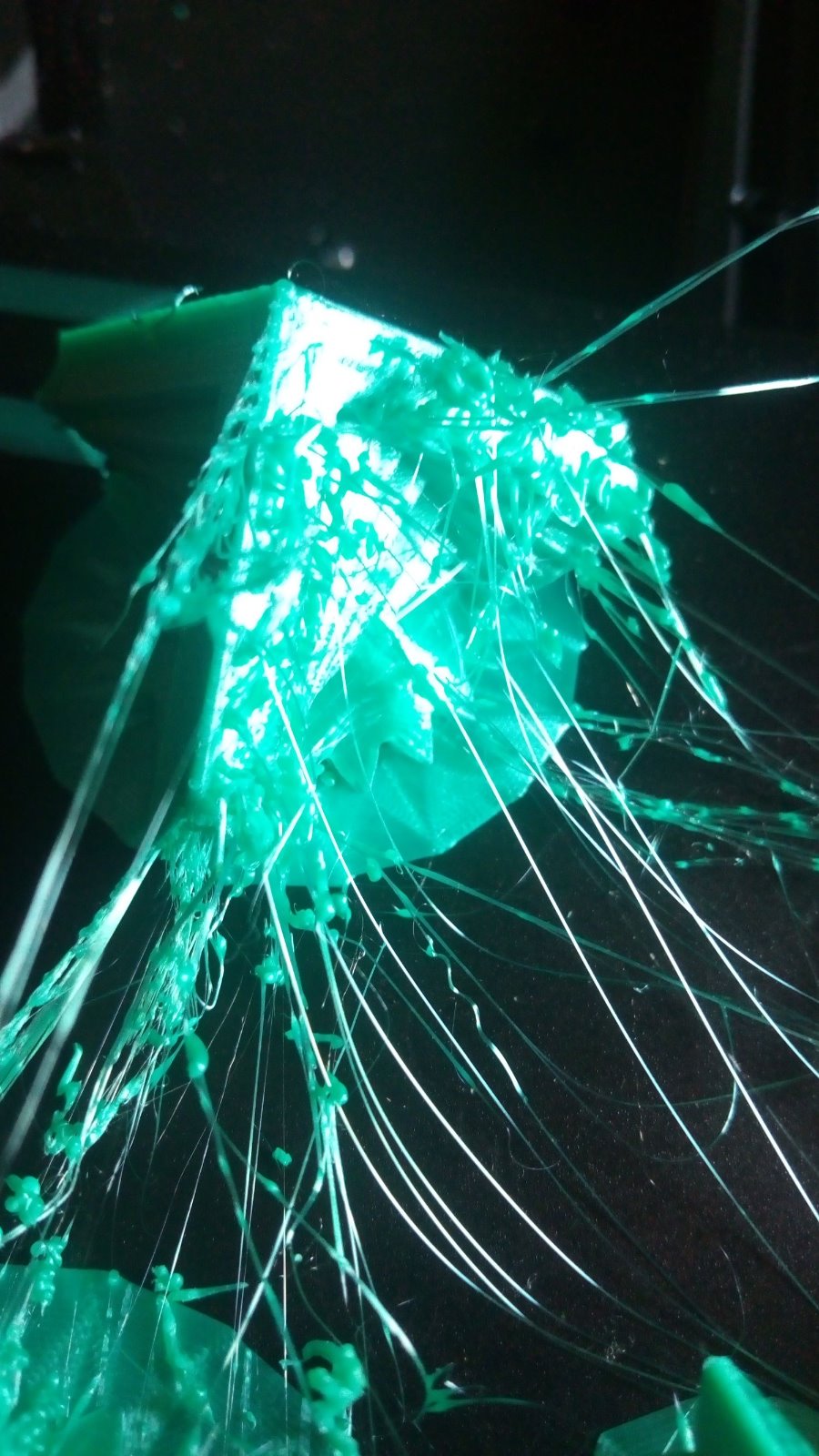

ok so yesterday I calibrated my extruders on my A20T today ive spent bent over a hot printer printing off the retraction calibration stl and slicing it using cura no matter how I try increasing and decreasing retraction values retraction speeds hot end temp and z hop values each test print is coming out the much same except if I increase z hop too far then well you can imagine'
cura 4.5 allows up to 10mm retraction distance and speeds up to 70mm/s but all the prints are coming out much the same still so I jumped over to repetier host as you can increase the retraction distance further but no exactly the same what am I doing wrong.

- retraction1.jpg (171.31 KiB) Viewed 17712 times

Hi,the possible reasons for this situation are:
1. The model is too complicated and the model size is too small.
2. Model cooling is not enough. 3. Withdrawal parameter of model setting
Treatment:
1. Reduce the sharp corners, thin walls, and cantilever structure design through model processing.
2. Increase the wind power of the cooling model fan. 3. Adjust the drawback speed and distance (do not exceed the drawback distance Over 6mm)
Hope to help you!

thankyou for your reply the model is the simple retraction test model from thingiverse just two simple posts on a flat base the rest between the posts is unwanted material from the nozzle its so many strings and blobs that it dose look like a much more complicated model so you see the extent of my woes however i figured this way if this liquid from the nozzle is too liquid that may be the problem and no amount of retraction will be able to suck that liquid back up its just going to keep dribbling so i reduced the hotend temp down to 190 as an experiment and blow me if i I haven't got my first clean print of this retraction test model and my very first clean print of wooden cat BY pmoews from thingiverse
im going to carry on experimenting to see at what point when increasing the temp the problem rears its head again

I have the same issue. I reduced the temperature to 180°C and still have this issue.
Could it be caused by the quality of the PLA?

If you are printing a single colour make sure the other 2 filaments are pulled out of the hot end slightly. I found that it was causing issues with retractions not relieving the pressure in the hot end. Made an instant difference when I realised after doing the multicolour test print.
I now have it taken care of automatically in the code I use, but very frustrating till I realised.
