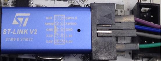

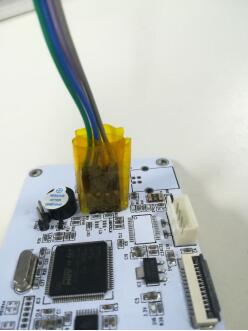

Re: A30 blank screen
Posted: Tue Jun 09, 2020 11:12 am
by William
Hi,need to connect first: VCC of ST LINK is 5V. And please pay attention to GND and VCC, look at the color of the line (pictured). You can use the st-link brush to guide when the line is connected correctly.
