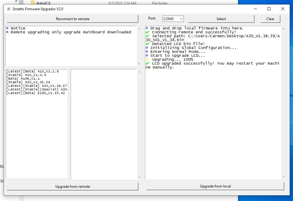

Re: A30 blank screen
I tried that and got a successful upload to the mainboard, heard the mainboard restart, then I uploaded the LCD bin file successfully. I then turn off the machine and turned it back on and the display is still black.William wrote: Fri Jun 05, 2020 6:16 pmhttps://www.geeetech.com/download.html?download_id=38
Hi,the official website's firmware is available, you can update it according to the instructions
- Successful upload but display black
- Success_upload.JPG (79.36 KiB) Viewed 10642 times

There is nothing on the display. It is completely blank. Even after the successful firmware update. The red LED is 'ON" on the back side of the display but the front of the display is blank and looks black.

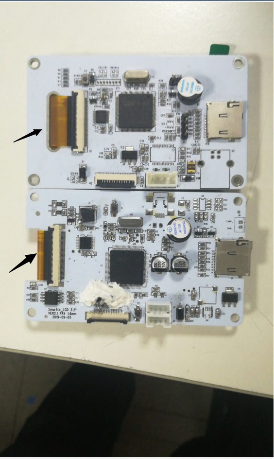

Again: my display is the one on the top of the picture you provided.
Thank you for your help.
