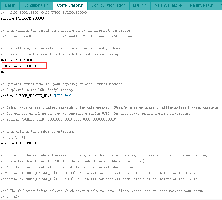

hi
i have this printer
https://www.geeetech.com/geeetech-prusa ... p-997.html
and the firmware PI3A Pro.zip (http://www.geeetech.com/forum/download/file.php?id=2100) dont work
there are so many errors!! (out of date?)
if i use the newest marlin firmware dosent work the display
here the display settings
pls help me

is in the 3 in 1 box a GT2560 with ramps 1.4 or a ultimaker board?
in the description of my seller is ist a ramps but the Firmware here is for a ultimaker??
//EDIT:
with the 1.0.1 it works many thanks to you
but is it ramps or ultimaker!
Re: Firmware for geeetech 3D printers
Find it in the "board.h",it's Ultimaker:
