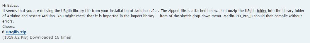

I have a 3D printer PI3A Pro and I suspect its Z axis is reversed, because when I send it to origin (and Z home consecutively), it goes up instead down.
So I tried to change it on the firmware, for that,
I'm utilizing Arduino 1.0.1 and downloaded the following firmwares:
- I3A Pro
PI3A Pro(for the upgraded kit using lead screw)
and both of them are appointing the same erros when verifying, even before any change and after importing U8glib library.
http://www.dropbox.com/s/yzjqw8u6gk9ys9 ... s.jpg?dl=0
Re: Firmware for geeetech 3D printers
Posted: Fri Feb 17, 2017 6:05 pm
by bang
Mako wrote:Hi,
- I3A Pro
Have you read this post?
- U8glib.jpg (19.54 KiB) Viewed 22559 times
Download the file and retry it.
