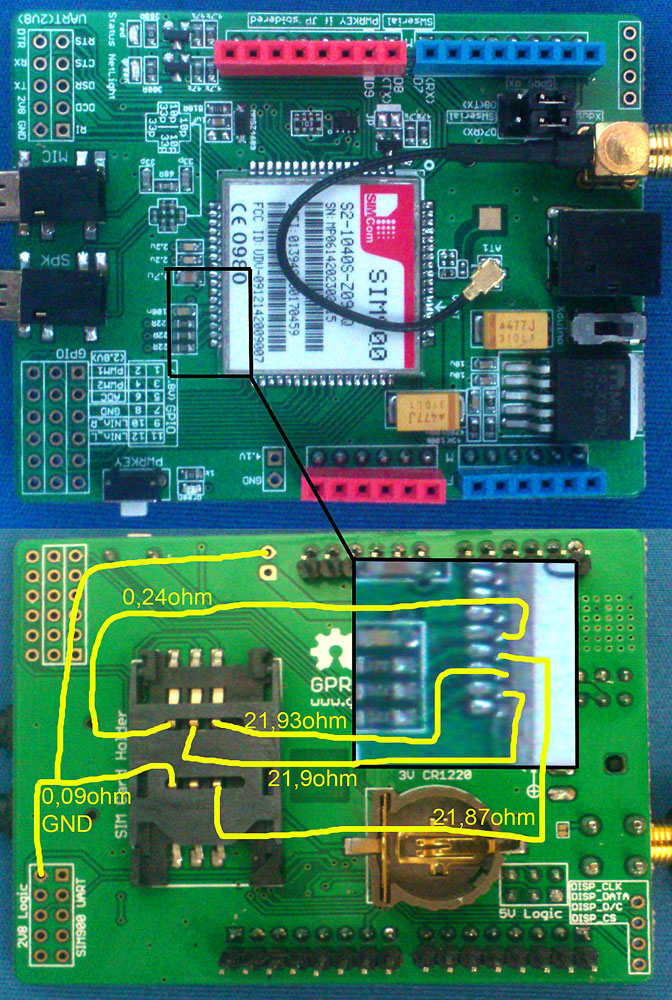

Re: GPRS Shield does not work
I measured all soldered connections simconector to sim900 and everything is soldered well, the picture shows the measured values certifying that the connector and soldered connections are ok, there remains the error in SIM900,
All of Geeetech products have undergone first rigorous testing and second sampling inspection by professional inspectors.
It is almost impossible for us to ship you a defect driver. But it may be caused during transportation.As you know international transportation is hard to control, the package may not be treated friendly or handled improperly on its way to you. And the static electricity may cause short circuit,which is deadly for the chip.
I suggest you to contact the seller for further solution.
