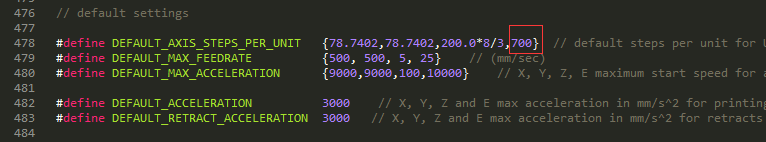

I'm sorry that estep 100 is for 1.75mm filament, and 760 for 3mm filament which you're using, so you should adjust it down to 750 or 700.
Edit it in firmware ''Configuration.h'' and reburn it into the board, then settings will not change.

ok so even if i set the the estep back to to 700 the extruder runs initially but then the motor then jitters, the filament still forms a plug at the end of the filament that cannot be fed back through the feed hole.
