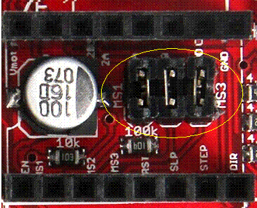

And the endstop is not the reason why the motor didn't move(which axis was it?),
maybe sth wrong with the motor driver,
3 jumpers under the motor driver A4988 should be connected.
As the picture shows, please check it.

I can confirm all the jumpers are installed and it is all three axis that are not functioning correctly

Post by buzmal »
I Can confirm all the jumper are in place and have had some success getting the z axis to move smoothly by adjusting the voltage on the stepper driver, i moves in the oposite direction to the button clicked in repiter host but is running, the other motors still just pulse back and forth when given inputs from the manual control screen
