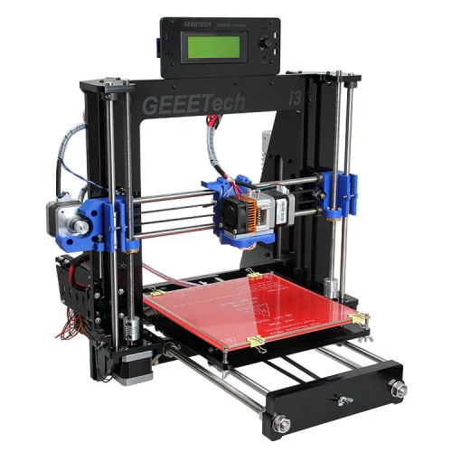

ABS is better. Can you take a picture of your extruder support?hamboner wrote:It seemed that i had a handful of issues that are now mostly solved. I got a caliper that measures to .01mm and turned out my filament was closer to 1.81mm (vs the 1.68mm default in slic3r). I think the default manual feed speed in repetier was too high for the nozzle size (0.3mm) so it was skipping. I was also having some issues with my filament coming off the spool and therefore not feeding properly. I mounted the spool next to the lcd on the top rail and that has seemed to help as well.
I will say that after a few hours the extruder support piece is sagging like others have complained about. I had to run a zip tie from the extruder feed screw to the carriage bracket in order to stabilize the extruder enough to print a replacement.
Is there a solution to the sagging extruder support? Updated design? Print out of ABS instead of PLA?

One thing i noticed is that the i3b STL files i have and my printer both came with the carriage support that is flat across the front, but the pictures i see on you website show a rounded notch on the bottom of the front side of the carriage, like in this picture: http://www.geeetech.com/images/s/Geeete ... hi3pro.jpg
Is there a new carriage design that would help? I re-printed in PLA, but will switch over and see if i can get a good print in ABS.
- Posts: 1405
Re: Prusa i3 acrylic extruder problem
Yes, we re-design it for a firmer assembly.hamboner wrote:It was starting to look like this: http://www.geeetech.com/forum/viewtopic ... 14&t=16107
