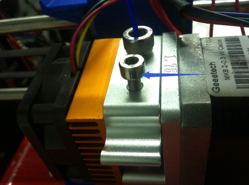

You can rise the temperature of extruder to 260 degrees.
And you can adjust the intensity of extruding by the thread, which is shown in the picture.

I have tried to adjust the screw but not helping I will try to set the temp higher later today
