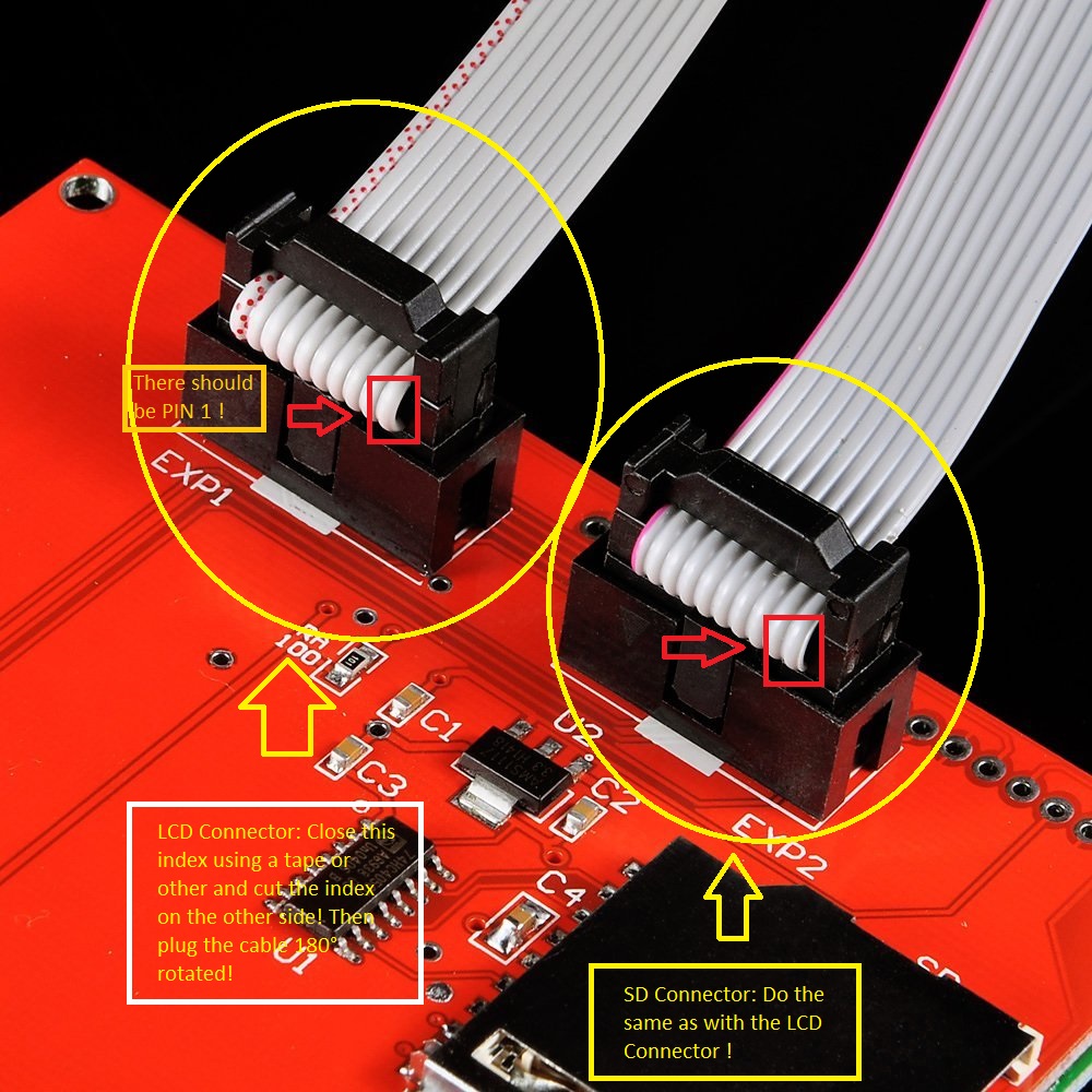

Hello again,
Yes, for the LCD12864 from bigtree-tech the connectors should have been mounted 180° turned, but here I have a modification.
All you have to do is just to turn the cable connectors 180°.
Still, please do the checks with a multi meter before retrying, I take no responsibility if it is not working for everyone !!
Be warned and measure first before damaging your equipment .
I just know it worked out for me and with the bigtree-tech LCD12864...
In the attachment is a small image, which might help...
Best regards,
Raisa
Best regards,
Raisa
- Modification... do at your own risk !
- Mod_LCD12864_bigtree2.jpg (291.36 KiB) Viewed 21943 times

Hi there,
As Raisa suggested me, I've turned the connector 180 degress and it's working fine now.
Many thanks Raisa.
Cheers.
RMRodrigues.

Re: LCD 12864 with GT2560
Thanks Raisa,
I have done it,Started working
