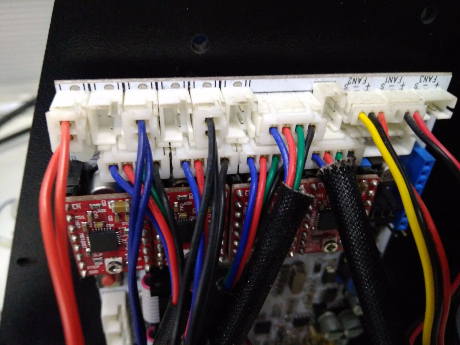

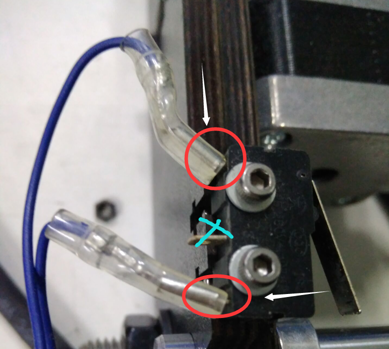

hello I am having an issue when homing my printer. all of the motors are going in the correct direction,
the Z axis homes properly with the endstop, but then either the Y or X axis (whichever one makes it to the endstop first)
will just make a horrible sound pressing up against the endstop as if it is not there. I try using the endstop from Z(because work just fine) at X and Y to test if it the endstop itself, but i have the same result(horrible sound pressing up against the endstop as if it is not there)
I followed all of the directions for wiring and I have tried changing endstop functionality in the firmware,
but nothing seems to work. What im missing ?
Re: Common issues :wrong motor direction,Endstop hit...
You can send M119 code and you can confirm that Endstop is intact via analyzing its return value
You should also ensure the wiring of Endstop is correct
