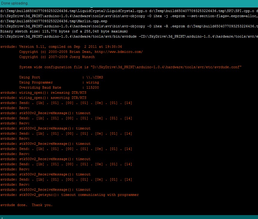

No I did and this is what its doing...trying to connect I also enabled "debug communications" to see what its doing (sending this M-105)
I made mine work just now. Follow the ff steps, it might help you as well.
1) Use Arduino 1.0.4
2) Download the Marlin-PI3 Pro B
3) Connect the USB and open the Device Manager. Once the new COM port appeared and detects your board (remove all motor driver boards), delete the driver and update it with the updated one.
4) Open the Arduino and the Config.h file.
5) Select the TOOLS tab and select the AtMega 1280 (not the 5260). That's if the main processor in your board was the AtMega 1280. But if it is the original AtMega 5260, choose the 5260. For sure, its the 1280.
6) Choose COM3
7) Choose "Arduino as ISP" as PROGRAMMER
8) Verify the file
9) Open the SKETCH tab and choose the Verify and Compile
10) Select the UPLOAD button
Try those steps and let me know if it help you. Good Luck!

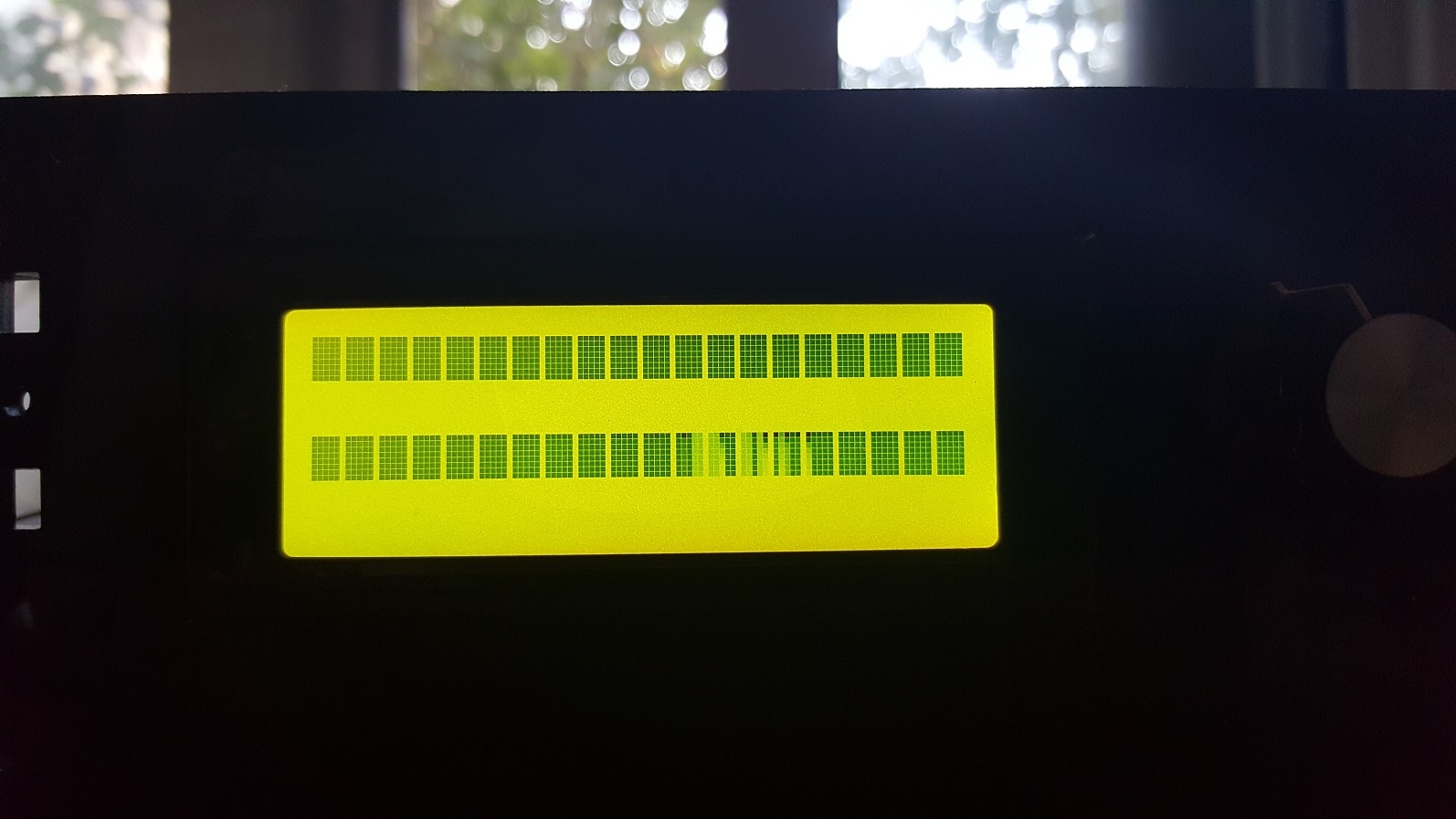

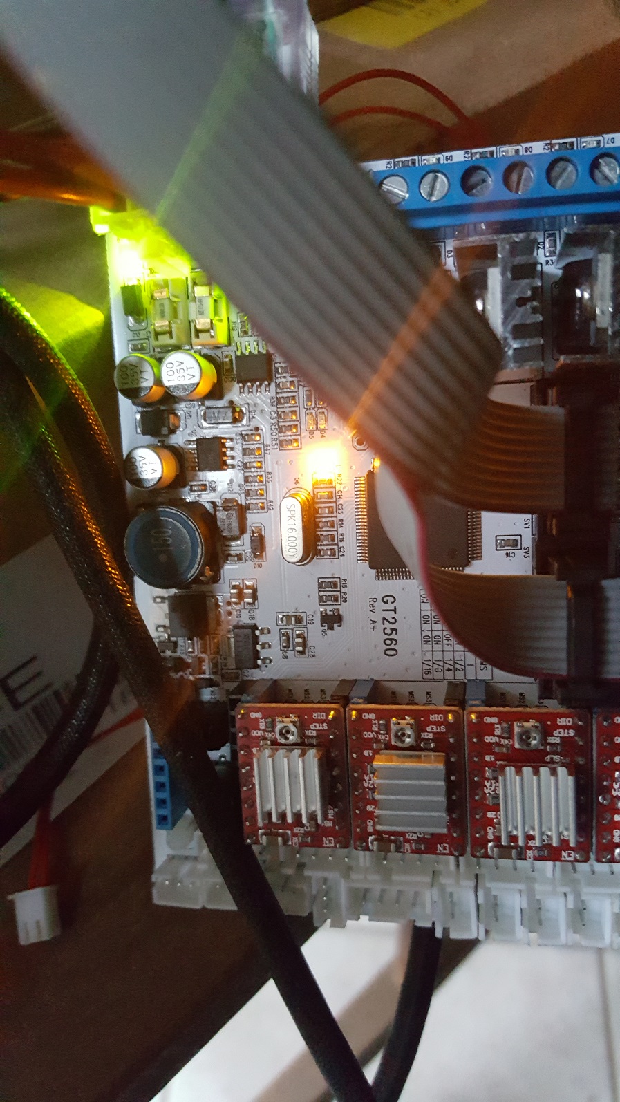

No luck... the only think changed is that after 5 6 timeouts I get avrdude done(see photo) but still nothing... I get this on the lcd and board flashing.
