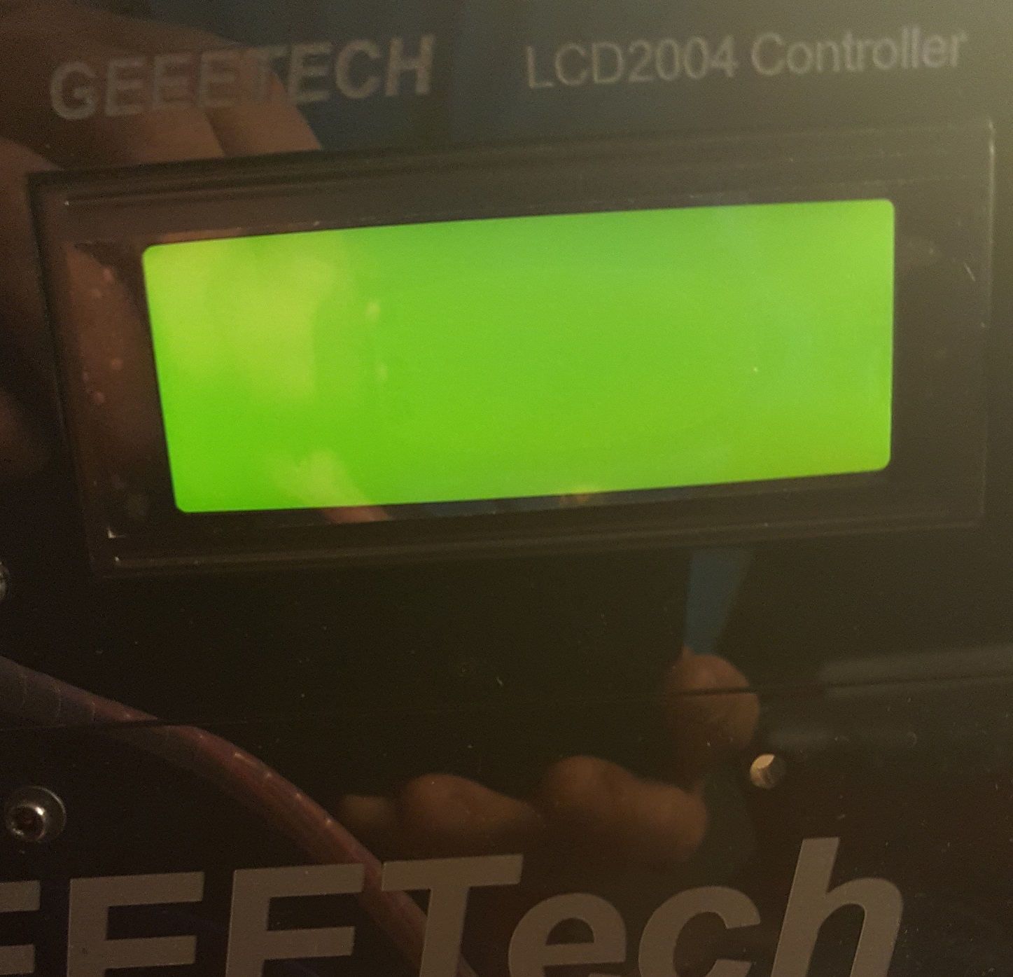

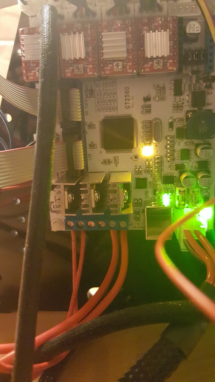

I bought the Geetech I3 Pro. Build was easy but I have a huge problem connecting to the printer.
1st I tried to connect directly to the gt2560 but I always get the "avrdude: stk500v2_getsync(): timeout communicating with programmer" whenever I try to upload to the board.
Of course I cant connect to any 3d program. I used 2 PCs Windows 10 & Windows XP. My arduino Duemilanova works fine on both PCs.
2nd I tried to BURN the bootloader on the GT2560 with the Arduino. I folowed the instructions from the forum and when I plugged everything on the Arduino and plugged the USB the Arduino( the COM port) disappeared.
When I removed the 5v wire it showed up again.
So I decided to plug in the power on the GT2560. With the power on everything was OK with the com ports and arduino.
So I tried to burn the bootloader and I got "avrdude: verification error; content mismatch".
After that I get a led blinking on the GT2560 and the Board is dead!(See photos)
I have contacted Geetech to send me another Board because I m sure there is something wrong with it.
Any idea somebody?
Thanks Jason Greece

there is no way to make it work I have tried 3 different Arduinos a USBasp programmer...nothing!
The only think is that with the USBasp and avrdudess I connected everything and Avrdudess found the Atmega2560 successfully, and also burned the bootloader successfully.
Then back to the arduino Marlin software excactly the same no upload.
I am thinking maybe there is a problem on the USB chip. Maybe it was faulty from the begining!
I have contacted tech support to send me a new board and got no answer for 5 days now!
Please help!
Please help!

Nothing tried everything, also changed the crystal from an old Arduino I had.William wrote:hi,you can check this link:viewtopic.php?f=20&t=17102
I think this may help you.
NOTHING
The only reasonable thing is a damaged USB chip...so I need a new board!
