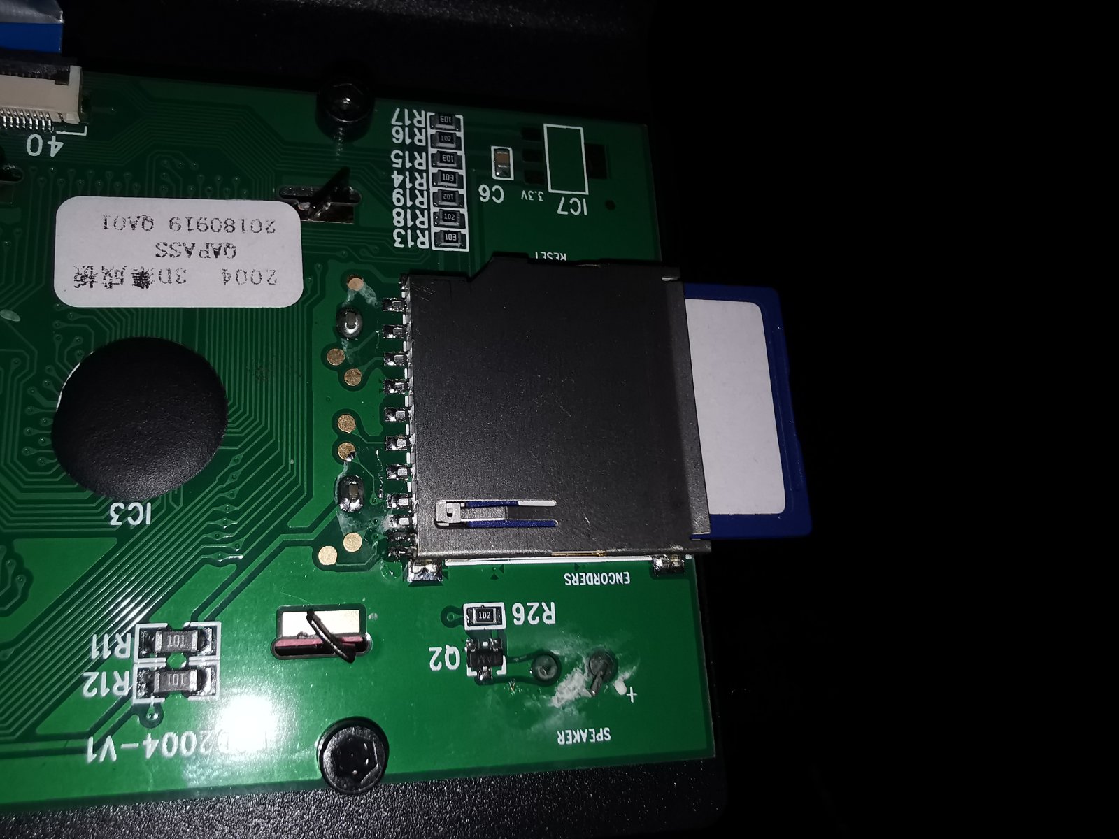

Hello
My motherboard does not boot anymore.I have an A10M.
Have a UNO attached
Unfortunately, these pins do not work for me.
my lcd board is slightly different
my A10M
Here is the picture of William

Hello
I order now a FFC 40Pin pinout board. Let's see if I can connect then.

Well that's kind of frustrating the they change the board but still mark it v1!!
I'm having the same issue. Were you successful in programing using the cable?

I have done some research to find a better and easier way to burn the bootloader.
The idea is to disconnect the cable to the LCD and use it to connect to the board directly from the Arduino
So here is my solution with loads of pictures
