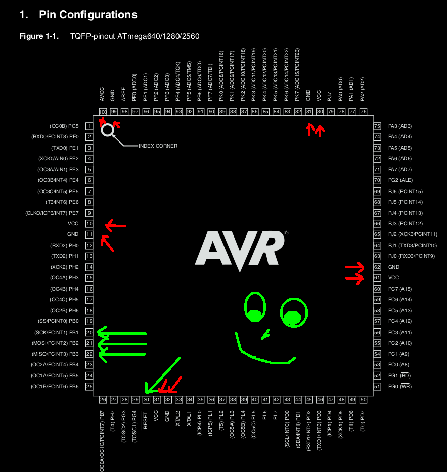

I have read and understand the article at https://www.instructables.com/id/ATMEGA ... duino-UNO/
I have looked at the pinout for the atmega2560 chip available at http://ww1.microchip.com/downloads/en/D ... asheet.pdf
I have viewed the GT2560 v3 Schematic that I found on these forums. I can't find it now --- very hard to find.
So the solution boils down to the following board connections:
UNO pins -> ATMEGA2560 pins
10 -> 30 (RESET)
11 -> 21 (MOSI)
12 -> 22 (MISO)
13 -> 20 (SCK)
5v -> VCC
GND -> GND
The problem, as I should have described it better, is that i can't find any place on the motherboard (even with the diagram) to probe MOSI, MISO, and SCK --- except for on the LCD & SD CARD FFC40 strip. I guess I was just hoping there was another terminal on the board I could probe for this. Or even a terminal on the LCD board that could be probed. I don't think it exists. I cannot find a diagram for the LCD board.

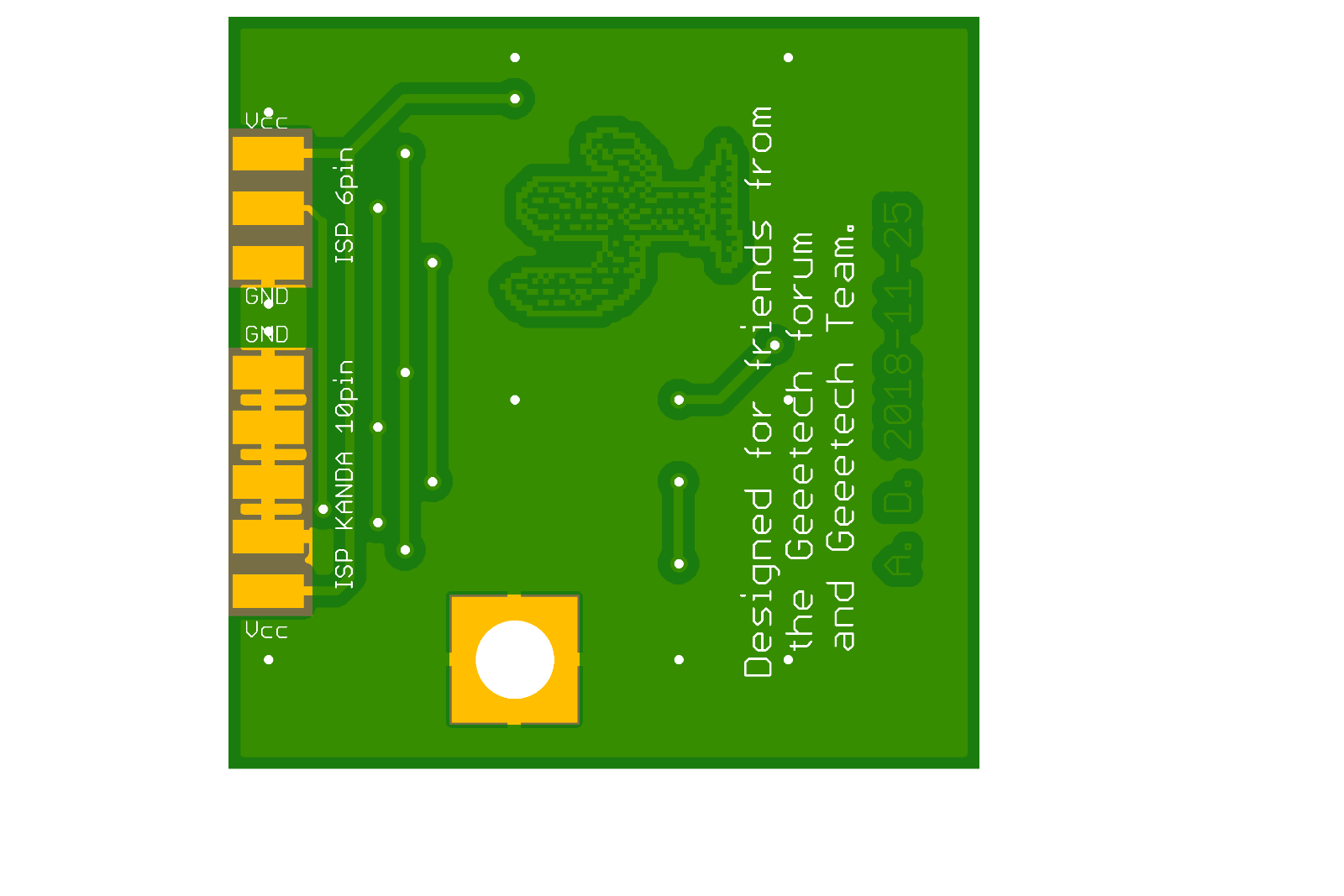

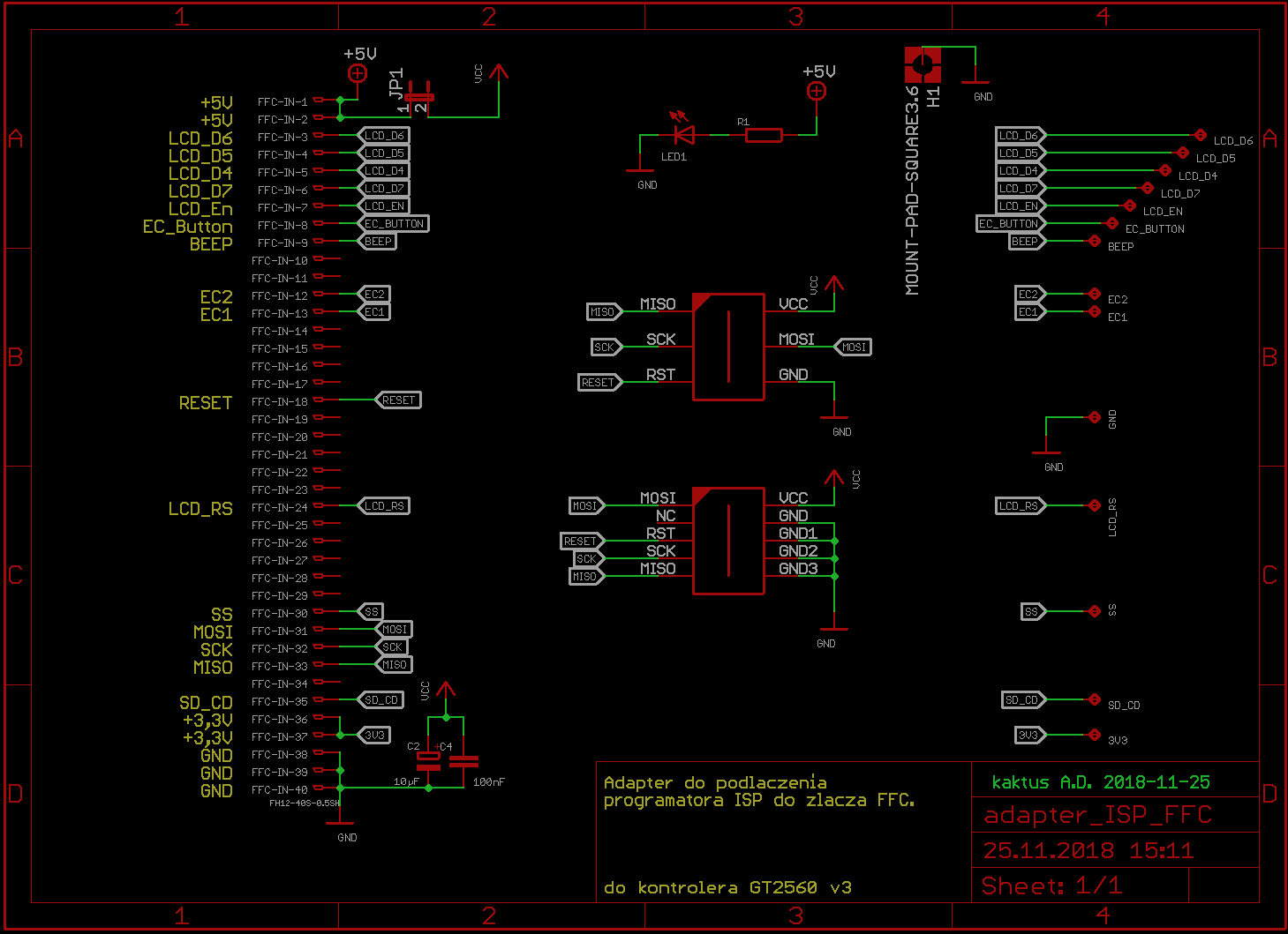

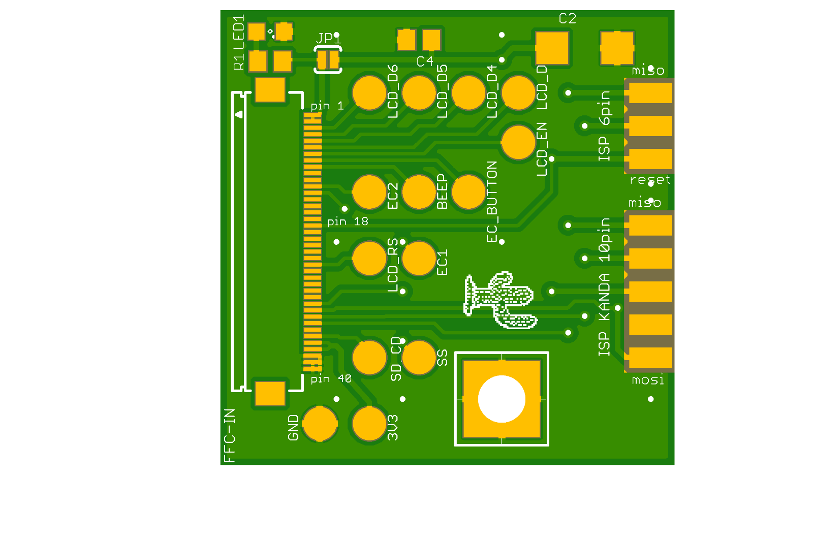

I have prepared a FFC <-> ISP adapter project.
Thanks to this small board such operations will be easy and not much work to carry out. :D
In place of the LCD module, just plug in an adapter with an ISP programmer interface. I have prepared two popular variants of the programmer connector - ISP KANDA 10 pin, ISP 6pin.
The issue of production order remains open ... Maybe GT team will take up the challenge :?:
widok od góry
widok od góry
widok od dołu
widok od dołu
schemat
schemat
The PCB is a square shape with a side length of 35mm.
If someone had any suggestions, it is a good moment to consult them now. :lol:
Geeetech filament, ABS only

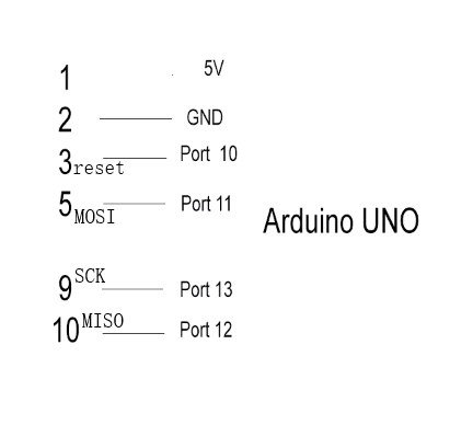

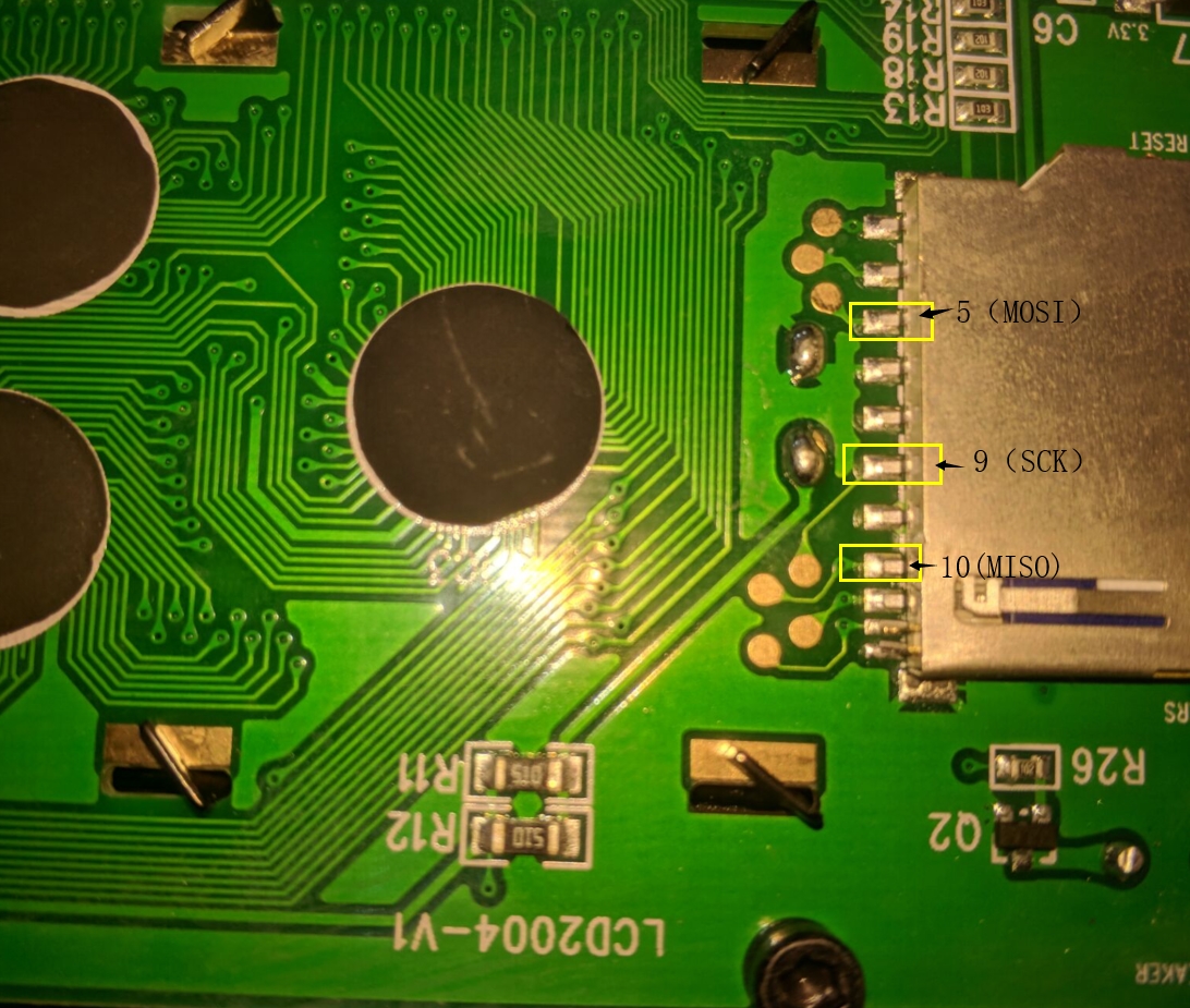

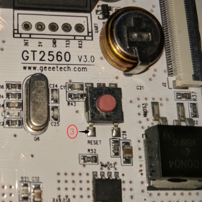

Re: Flashing GT2560 v3 Bootloader
Will this be helpful?

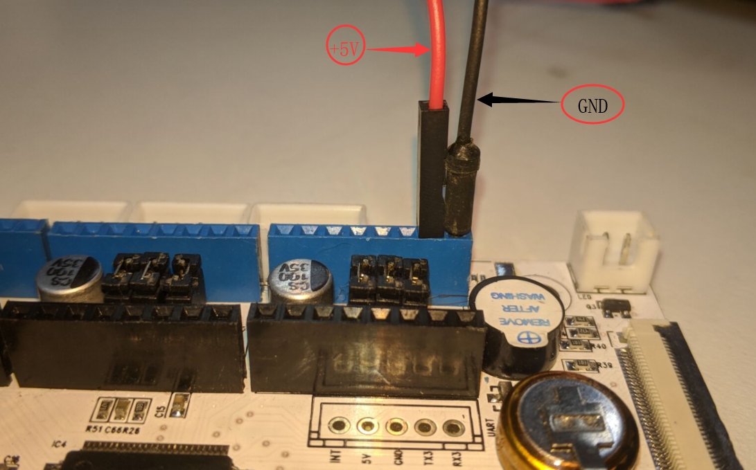

1.The Vid:
https://www.youtube.com/watch?v=2N1zgX8Gv54
Attached wires;
2.The pic:
GT2560V3 bootloader1.jpg (26.29 KiB) Viewed 18743 times
The Gnd and +5V:
GT2560V3 bootloader2.jpg (341.83 KiB) Viewed 18743 times
The 3(Reset):
GT2560V3 bootloader3.jpg (259.41 KiB) Viewed 18743 times
The 5(MOSI)+9(SCK)+10(MISO):
GT2560V3 bootloader4.jpg (662.9 KiB) Viewed 18743 times
vert wrote: Thu Nov 29, 2018 3:44 am
William wrote: Mon Nov 26, 2018 10:10 am Will this be helpful?
1.The Vid:
Attached wires;
2.The pic:
The Gnd and +5V:
The 3(Reset):
