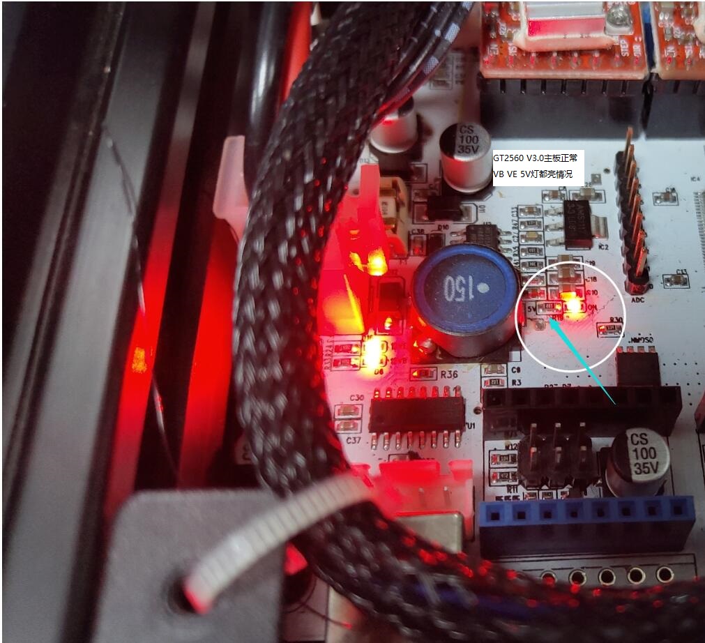

Hi, When you turn on the printer again, do the three lights on your motherboard light up?
like this:
like this:
Re: lcd 12864-3d
Yes all 3 red leds are lit solid.

Hi, When you turn on the printer, the three lights on the motherboard are lit but the screen is not lit.
You can reconnect the screen cable to try.
If the screen is still not lit, you may need to replace the screen and screen cable.

For my control board only one of the lights lits up, and it's not the one int the circle from the picture. So do I need to replace the control board?

Hi, the picture is not displayed,
but if the printer is turned on normally,
three lights on the mainboard will light up.

Read the name from the PCB, and write which LED is lit.befarfan wrote: Wed Jul 31, 2019 5:11 am ...
For my control board only one of the lights lits up, ...
Maybe you just need to buy a fuse.
