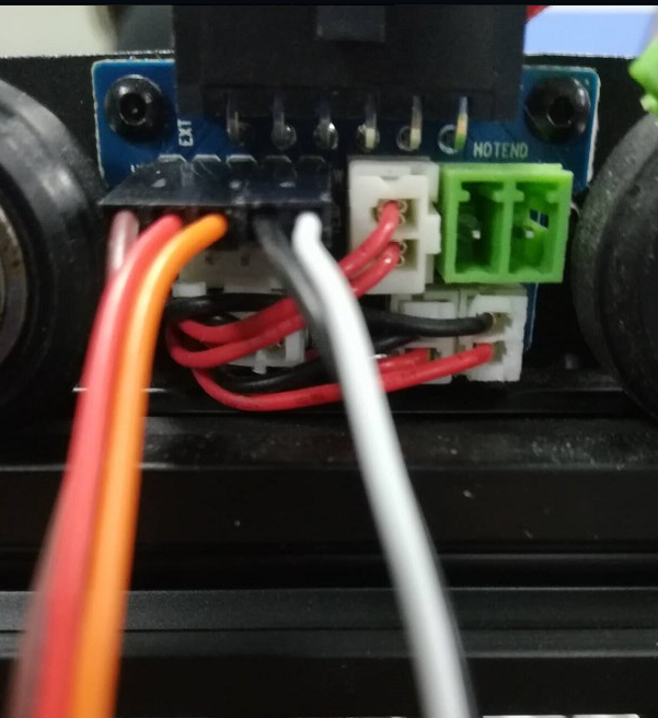

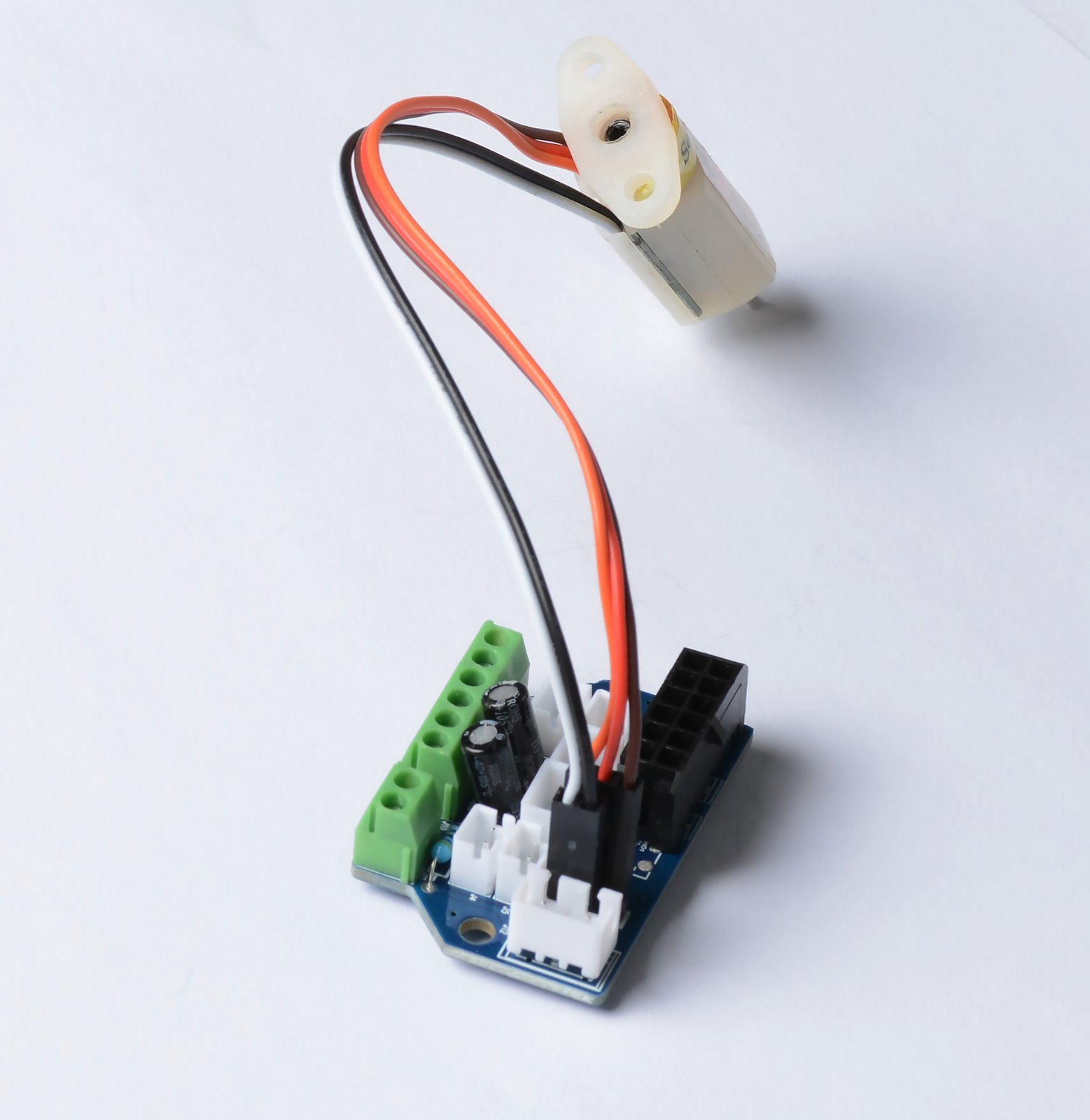

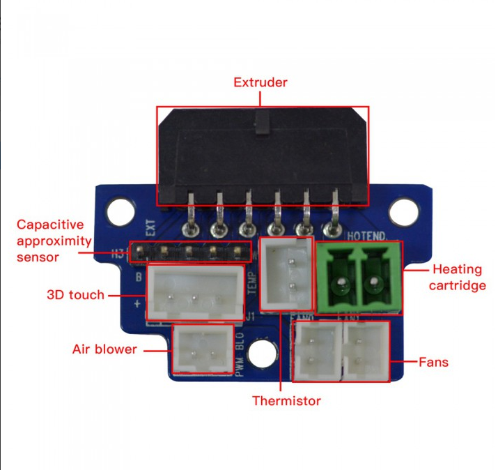

Hello everybody,
I would like to know if it would be possible to have photos, a diagram, or a detailed explanation of the new connection because I am a little lost with the wiring of the hotend part (extension card).
Thank you in advance for your help.
Re: SKR V1.3 on the A10 - Any pointers?
Hi,do you mean this?
转接板的3d touch接法.JPG (130.74 KiB) Viewed 28523 times
3d touch 接法.png (398.84 KiB) Viewed 28523 times
t2u
Posts: 4
Joined: Sat Apr 25, 2020 5:57 am
Post by t2u »
yes the extension card in photo.
I would like to know how to connect the extension card to the skr1.3

Matsubaa wrote: Mon Nov 25, 2019 9:55 pm Using the below images, I cut the connector off the control-board end of the hotend bundle.
I'm don't have the 3d touch connected yet but I've confirmed I've got motion control, heating and fans.
I've crimped on JST connectors for leads that needed them.
Pin -> Board Connection
6 -> I
7 -> H
8 -> D
9 -> H
10 -> D
11 -> C
12 -> C
it is this part that I do not understand very well, that is why I would have liked more detail on the wiring
