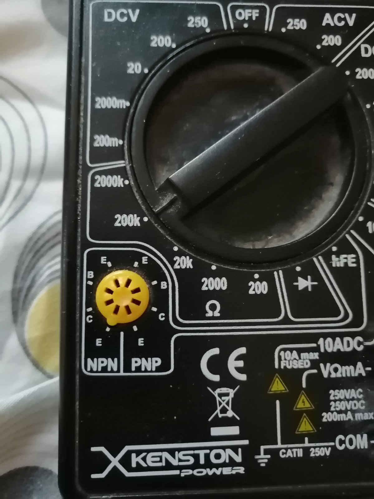

Re: My printer don't print
Between blue and green, the multimeter is on 200k ohm.
The value on the screen is 5.2
- IMG_20200330_194714.jpg (247.24 KiB) Viewed 19609 times
Today my bed don't heating
Hi, your hotbed thermistor is broken,
you need change it.
you need change it.
So, I just saw that it is more complicated than that, when the bed is plugged into the box (power supply, motherboard ...) I have 5.2 but when I unplug the cable, I have 122. The multimeter is still the 200k caliber.
Thanks
Thanks
It is break or not ?
Hi, based on your test data
This is not normal.
This is not normal.
