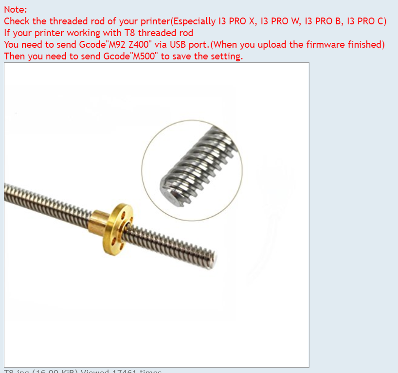

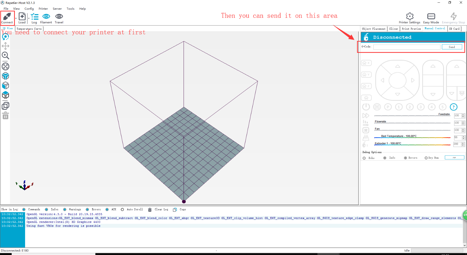

Hi, I have uploaded the firmware of my prusa 13 pro w with board GT2560, but I have a problem with the z axis home position, the y axis move up instead of down and if I reverse the z axis direction the endstop doesn't work. do you know which parameters I can modify to solve this problem?.
In addition I have this king of threaded rod, reading your instructions on firmware update I should send Gcode"M92 Z400" via USB port.(When the upload of the firmware is finished) and then to send Gcode"M500" to save the setting, but I don't know how to do, could you explain me the process? thanks a lot :D

giav wrote: Fri Aug 24, 2018 4:49 pm Hi, I have uploaded the firmware of my prusa 13 pro w with board GT2560, but I have a problem with the z axis home position, the y axis move up instead of down and if I reverse the z axis direction the endstop doesn't work. do you know which parameters I can modify to solve this problem?.
1.You need to check the endstop works or not
http://geeetech.com/forum/viewtopic.php?f=17&t=60927
2."G92 Z400"and"M500"
