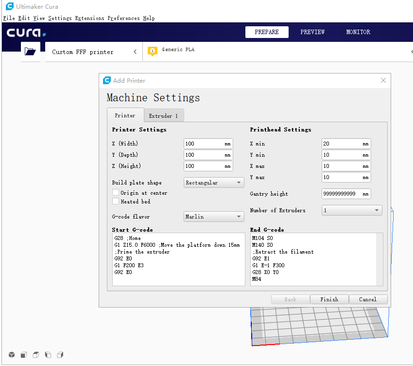

Hi, Did you set up your printer before updating the firmware?
You can provide more details so that we can solve the problem better.

I am referring to Cura printer settings.
Do you configure the printer?

William wrote: Fri Aug 02, 2019 9:21 am I am referring to Cura printer settings.9GQP0]DS6MK4PO(~%@`QLHA.png
Ho!no...
I test it now!

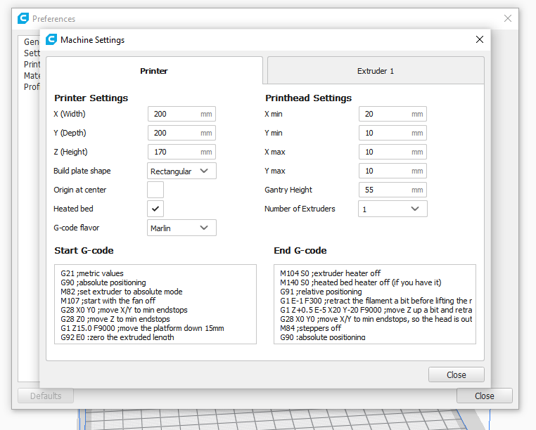

prob centre.PNG (59.22 KiB) Viewed 1920899 times
So yes, i look, and i have ever change it. Same problem, i can use 1/4 of plate and print is 3/4 smaller
