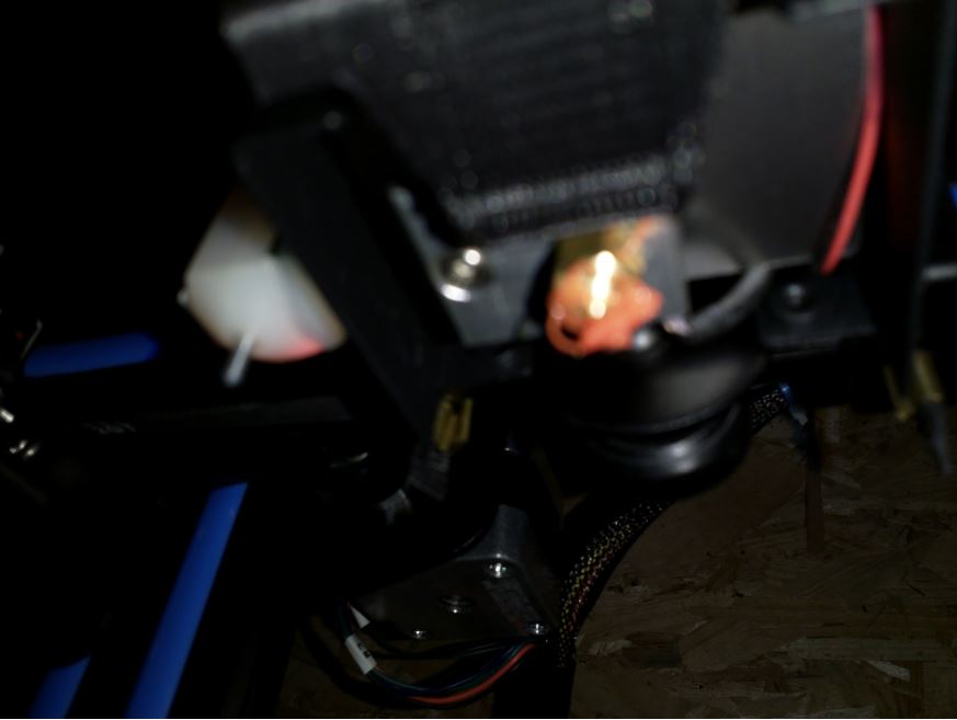

I rised up the bed temperature to 70° and extruder to 230°, guess what? it makes no difference still same thing happens this printer is really waste of money!

Im sure you're more talented than me, you are the best DIY guy on this planet but this printer is not working as it should be the day it get out of the box.vert wrote: Sun Dec 30, 2018 5:52 amI do 24h long prints on my a10 your blaming the hardware for lack of skill. The video proof is on my YouTube channel check it might learn something.diler35 wrote: Sun Dec 30, 2018 5:46 am I rised up the bed temperature to 70° and extruder to 230°, guess what? it makes no difference still same thing happens this printer is really waste of money!
Well, somethign is wrong with this printer, i have fixed/repaired many things but this machine just don't want to be repaired.

You need to use the PID tuning then check the ptfe tube plug to the hotend enough.andileibi@web.de wrote: Sat Dec 29, 2018 7:06 am Hello, I had the same troubles, try to print with higher nozzle temperature. My one is working well now but only with a nozzle temperature of 230°C for PLA

Dont know if I am too late with this post but, I had the same issues, I have now increased my extruder temp to 210 degree, my glass bed at 75 degree and I now use a very sticky hair spray,,,all is perfect for me now.

I also use the geeetech parts paper to set my height, It seems to be a different thickness than an A4 sheet, If you had a good quality gloss print paper, that also adjusts height good.

Thanks for your suggestions.It will help others a lot.
