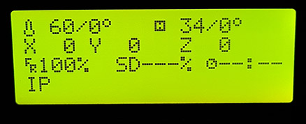

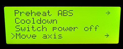

Here is snapshots from the menus:
- main menu
- menu1.jpg (40.71 KiB) Viewed 109668 times
- Prepare menu
- menu2.jpg (40.37 KiB) Viewed 109668 times

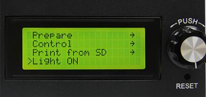

OK,but my printer's LCD switch is not in "Prepare" menu,it is in here:
- 1.jpg (10.48 KiB) Viewed 109666 times
- 2.jpg (10.3 KiB) Viewed 109666 times
Did you have a wrong place?

I forgot to take a photo of that menu, but I don't have anything beneath "Print from SD card"
