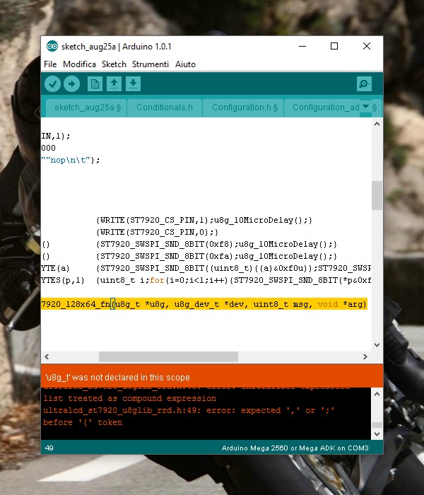

Sorry i have a problem to upload this firmware: 4) For prusa I3 A Pro with the 3-in-1 3D printer control box
the arduino find an error in the file.
please you have a working file?
the printer is new, is impossible to move the axis, the extruder and the other controls.....
the repetier connect correctly, i see the temperature sensor but not more.
i try to upload this firmware:
aluminum I3 Ramps 1.4
Prusa I3A 2560.zip
(281.17 KiB) Downloaded 828 times
and now the display not work anymore
please help me....

Re: Firmware for geeetech 3D printers
Hi,Stasky78 wrote:Sorry i have a problem to upload this firmware: 4) For prusa I3 A Pro with the 3-in-1 3D printer control box
Prusa I3A 2560.zip
and now the display not work anymore![]()
please help me....
You said your printer is I3 A Pro,so you should download the following firmware and upload it:

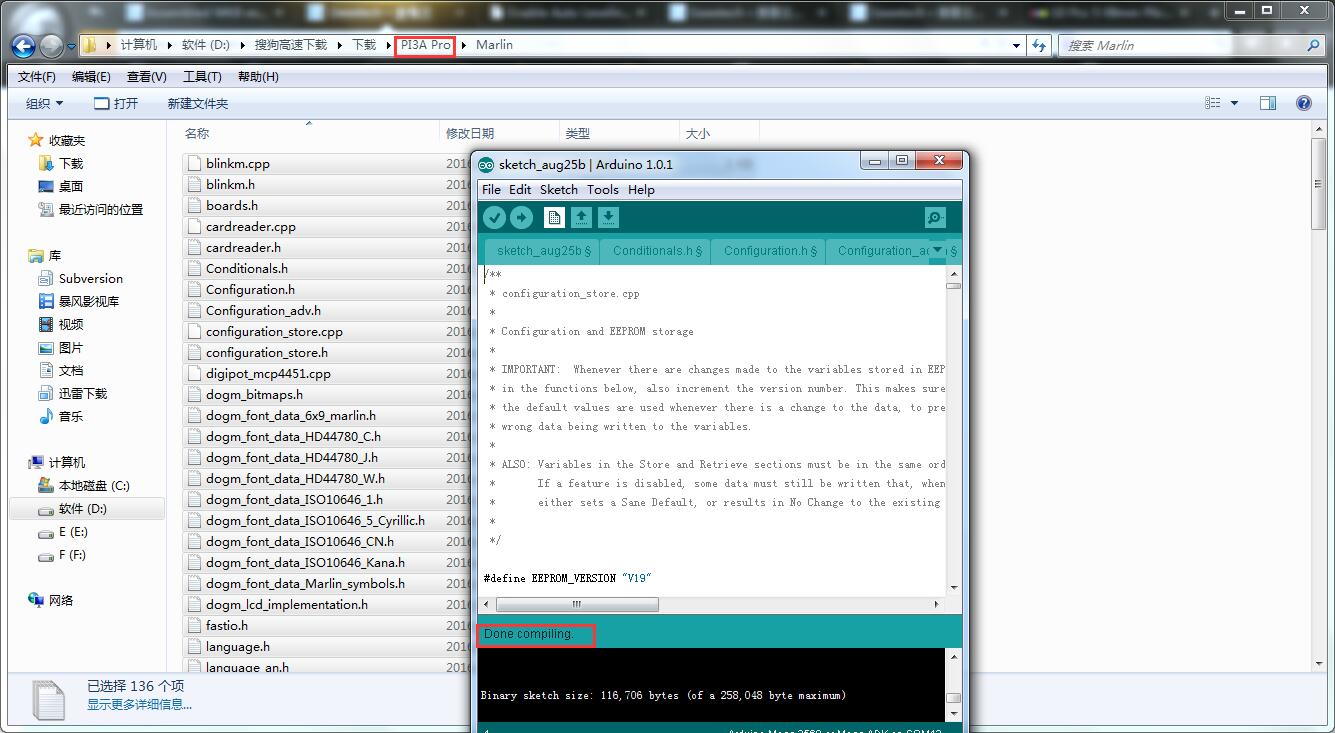

But mine is OK...Why?Did you modify your codes in the firmware?
Here is my firmware downloading from the same link:
