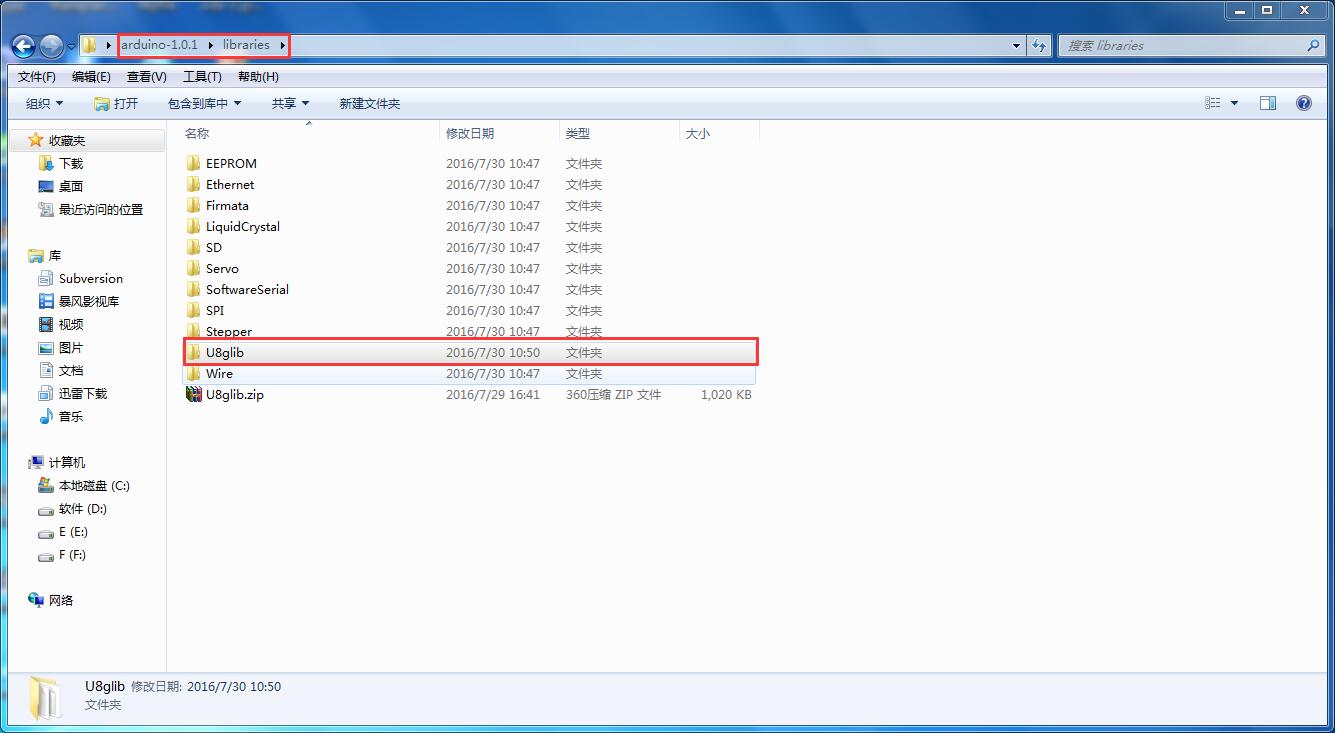

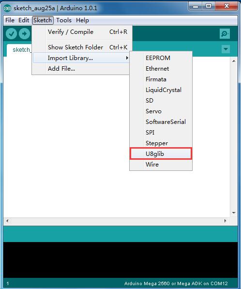

I guess your Arduino has no "U8glib" in the libraries:
You can copy unzip the zip file and copy the unziped file to the "libraries" of your Arduino installation contents,then it will work i think:
U8glib.zip
(1019.62 KiB) Downloaded 809 times

ok now work!!!!!!
many thanks :D :D :D :D :D :D :D :D :D :D :D :D :D
