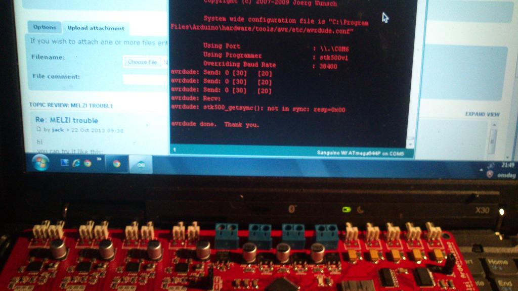

Hello now iv'echecked upp your solutions
1 autoreset jumper tested bot in place and not in place. no difference!!
2 if usb\pwr juper is not in place it des\nt detect board as com6 . so it must work..
3 both chip 4050D and ftdi 232 looks alright and well soldered in a weak magnifier.
4 sanguino w atmega 644p choosen.
this is what i get then when trying uppload arduino blink sketch..
any idea what to do next?
Thing is ,i got an sanguinlolou 1.3a self soldered exept ftdi chip swaped by expert.
It behaves exactly the same. and i have tried both on another notebook with Win xp home.. mayby try it an a vista desktop too?
melzi and arduino blink
