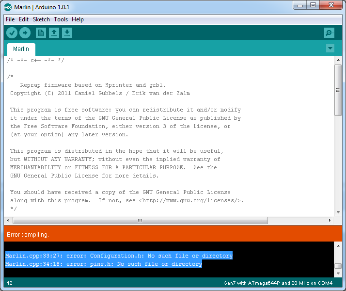

I did refer to the link/wiki, as I have been instructed multiple times by GeTech's staff and the forum moderators. It is incomplete. The files posted don't work. The Marlin.ino in the "Melzi printer.zip" downloaded from the Wiki can't even compile. I uninstalled the current release of Arduino IDE 1.0.5 and installed the v1.0.1 from the link in the Wiki. Upon opening the Marlin.ino in this outdated Arduino IDE, it notifies me it can't open it unless it creates a new sketch folder named Marlin and places the .ino file in that location. After permitting it to take those actions, I tried compiling the Marlin.ino. It presents the error in the first screen shot.

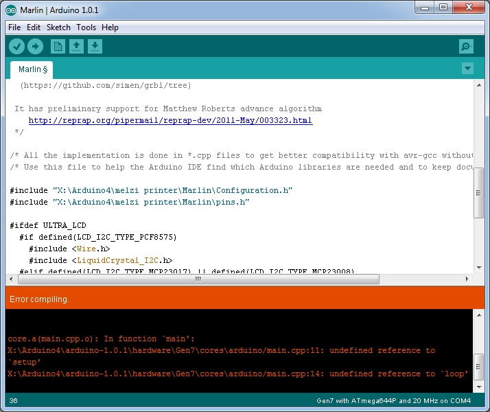

I reviewed the code and updated the paths to the Configuration.h and pins.h files. I then tried to compile again. Now it gets the error in the second screen shot.

That makes no sense. What attachment are you is missing?
According to Arduino.cc, this error means the sketch is missing the two basic required components of any Arduino sketch - the setup and the loop.

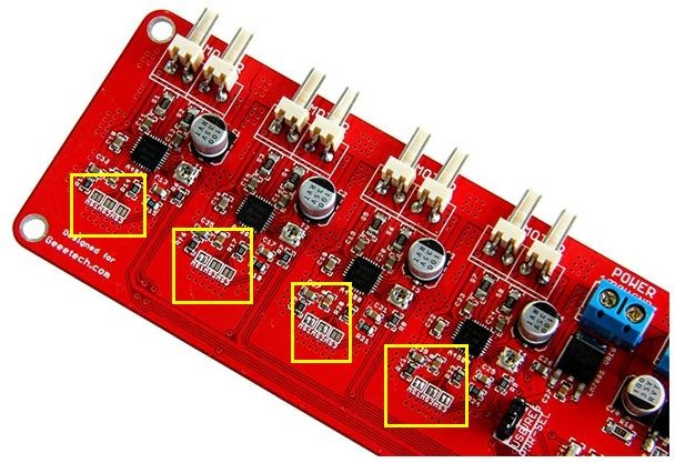

Re: Melzi Ardentissimo Failure
According to the figure, weld the plate connected, and then download code from the official website .
