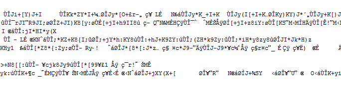

I bought at your store the "ArduIMU 9 Degrees of Freedom" and uploaded the ahrs software posted in the tutorial https://github.com/ptrbrtz/razor-9dof-a ... i/Tutorial. I followed all the instructions and set everything like it should be (e.g. correct baud rate, etc.). However, when I open the serial monitor the values shown there are only some weird characters (see attachment).
I googled a lot but I didn't find any solution :( I really would appreciate your help!
Thanks a lot and best,
Mat

HI friend:
You can enter the serial monitor, and then change the baud rate is 115200
