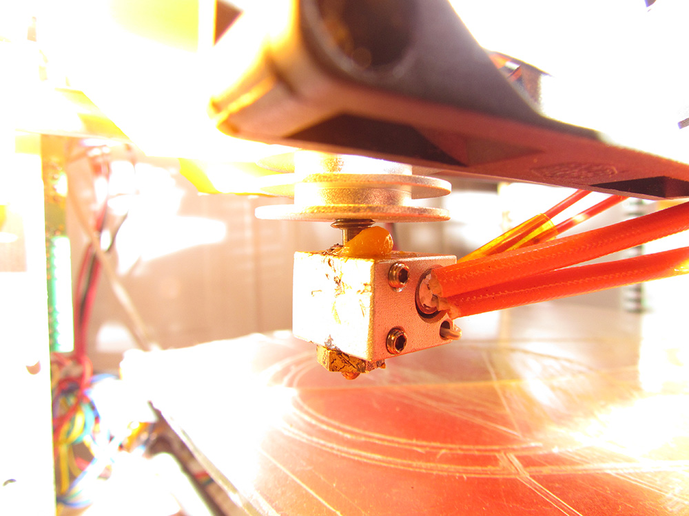

hi I just bought a getech all metal hotend and in my first print I found a leak in it, what can I do to fix the problem?

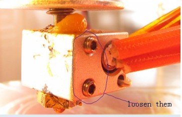

1.heating the hotend
2.Loosen the screws
3.then clean up your material
4.Tighten the hotend(be careful :)
5.Tighten the screws,the job is done,then you can enjoy your printing

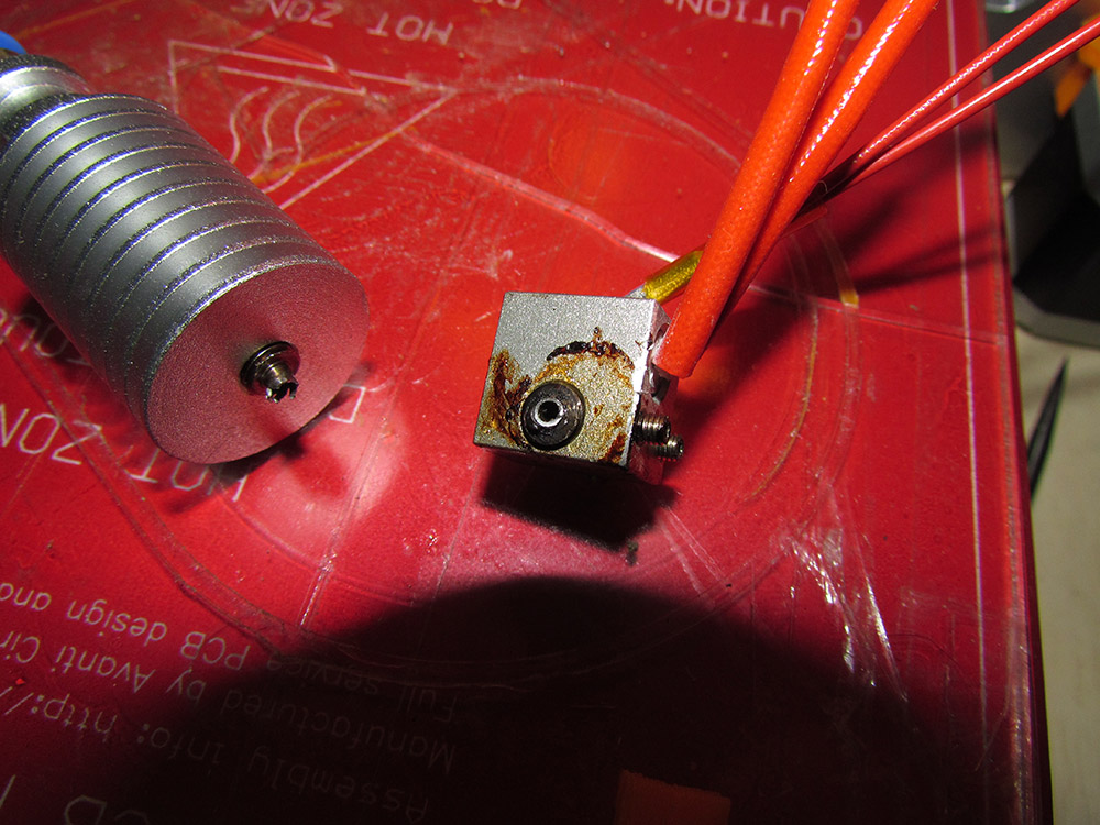

well, I did exactly as you said, and thats the result, I just hold with a pliers and tryed to Tighten and in the first move it broke...so..thats it...I couldnt print anything with this hotend.

well, just got a new screw on mail and assembled again, leaking still the same, so the thing is: if you try to Tighten it it will broke as the last one....if you keep that way it leaks...witch makes me conclude that the product is not well designed at all
