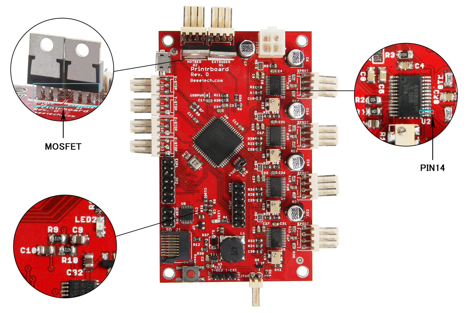

Re: Printboard several problems
Dear friend,
I'm sorry for my poor English.Mos tube means mosfet.
I have added a picture and highlighted the pins and mosfet.
You can have a try again.
Any concerns,please feel free to contact us.
Best regards
2)Check whether there is a short circuit after you connect 12V to the middle pin of the mos tube.......yes, it supply 12V to other pin.....
3)Check the mos tube is broken or not,test if there is bridge between the edge two pins of the mos tube........ no , bridge between 2 pins...
2.About the board shows max hotbed temperature.
Please check if there is a short circuit between the pin C9 and C10......I had checked, ...no short circuit between C9 and C10
3. X motor can't move invert. only move one direction.
1)Check if you have connected the endstop correctly............. already check enstop .... it work correctly......
2)Test the 14th pin of the A4982 chip can change from 0V to 5V...............no voltage change, 0V.
3)Solder the A4982 again...... it is so tiny ..... I don't think I can solder them......
4.No controll for Y motor.
Please try to solder or replace the chip of Y motor......... it is so tiny ..... I don't think I can solder them......... where can I find the replacement chip..........will you send me some
5.The LED on the board was off.... already solve... it was short circuit at stop switch soldered area.....

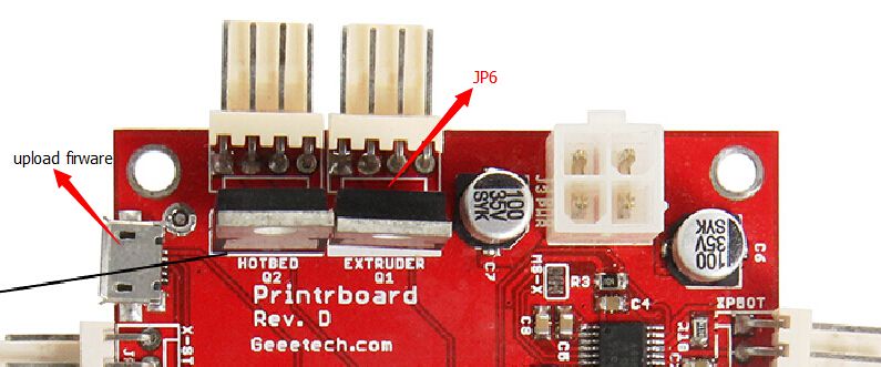

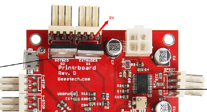

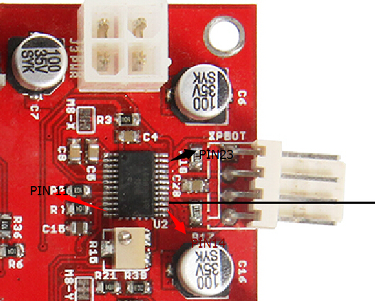

Dear friend,
Please try the following steps:
1.About the board can't control temperature,
Please check the picture I have added,use a knife to cut the circuit of the JP6.
Try to not connect the thermistor.
Use your Multimeter to test the voltage between the pin 14 (DIR) and GND,pin11 (STEP) and GND,pin23 (EN)-GND
About the chips,you can contact our customer service.
Look forward to your early reply.
Best regards
Please check the picture I have added,use a knife to cut the circuit of the JP6.........this is not right, I can't tell my customer to use the defect board.... it need to be replace...
Try to not connect the thermistor........this is not right, I can't tell my customer to use the defect board.... it need to be replace...
pin 14 (DIR) and GND..... 7volts
,pin11 (STEP) and GND,... no voltage
pin23 (EN)-GND ....5vots
today now problem on other board, after online the board, and start increase temp for hotend extruder and bed, my power supply switch off to protect the short circuit.
I think same problem as the JP6.... or short circuit somewhere

Dear friend,
Please help us to test the defective boards again:
1.X motor can't move invert. only move one direction.
Use your Multimeter to test the voltage between the pin 14 (DIR) and other pins,especially pay attention to the pin VDD.And remember not to connect the power supply.
2. After online the board, and start increase temp for hotend extruder and bed.
Please make sure you have chose the right port to upload firmware.(See the added picture)
1)You can try to upload the firmware we have provided in the previous post again.
2)Check whether there is a short circuit after you connect 12V to the middle pin of the mosfet.
3)Check the mosfet is broken or not,test if there is bridge between the edge two pins of the mosfet.
Appreciate you rpatience and understanding.
