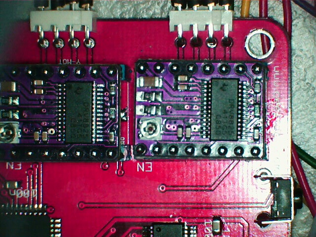

I can assure you that they are in the correct way round (EN to EN). I will take a picture later and post it. This board is faulty and it is not faulty because of the shipping. As a seller if a product is damaged in shipping then it is not packaged correctly. This product was packaged extremely well and there is no way it was damaged in transit.

As requested:
Lemon
Posts: 40
Joined: Thu Jul 03, 2014 9:13 am
Re: Azteeg
Post by Lemon »
Dear friend,
Thank you for your photo.
Could you please test the Azteeg corresponding Pin with DRV8825 as following:
1.The voltage between the STEP and the GND Pin;
2.The voltage between the DIR and the GND Pin;
3. The voltage between the EN and the GND Pin.
After you finish tested, please tell me the details.
Waiting your reply. Best regards.
