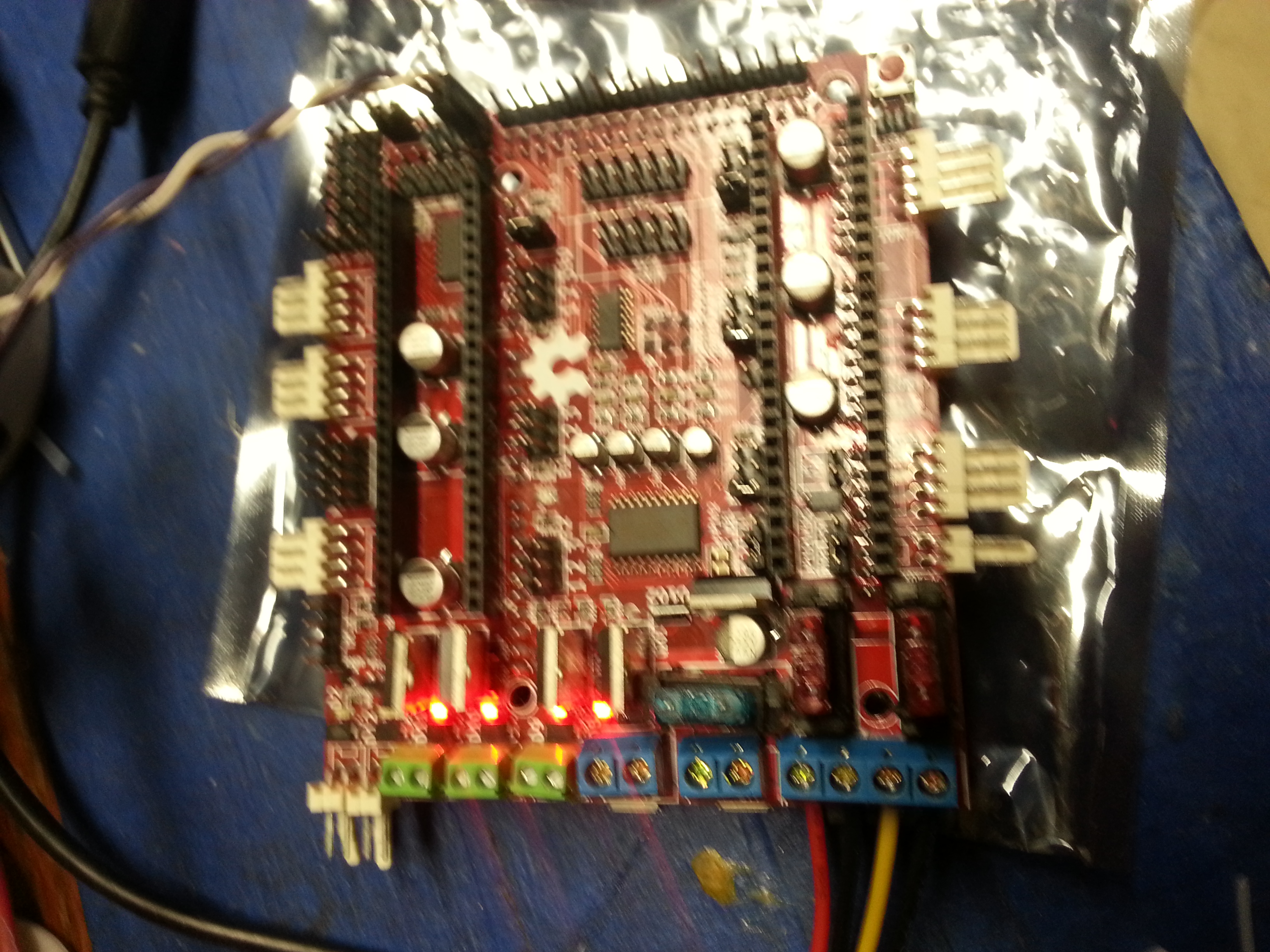

My ramps-fd does not function properly.
4 led's come on, and stay on.
I want to return, but they requested I post here first.

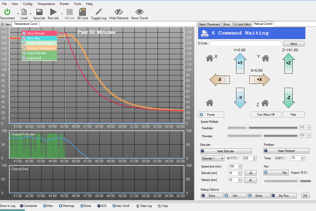

when usb is not plugged in, all the LEDs come on and stay on.
when usb is connected, the device shows up and firmware can be loaded, but after loading and connecting with Reperier Host it just says "commands waiting"
I have tried both USB ports.

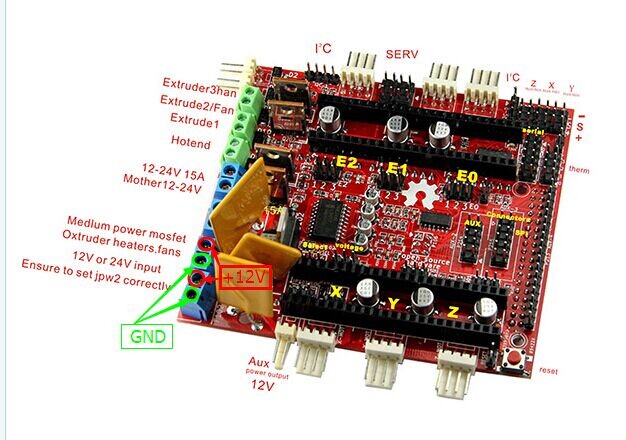

Dear friend,
Thank you for your reply.
Could you please connect the Ramps-FD according to the following photo? And upload the firmware I attach, to make the stepper motor work normal.
Please remeber that you have no need connect Ramps-FD when you uploading the firmware.
After you finish tested, please tell me the results.
Waiting your reply. Best regards.

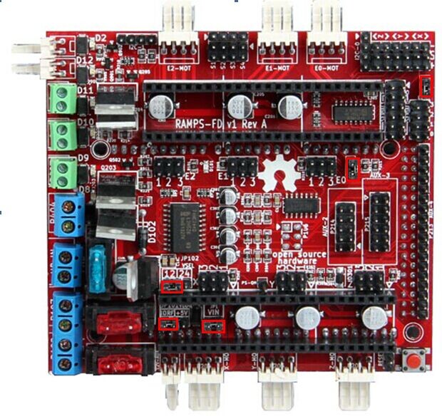

how should the jumpers below the X step driver be set?
JP1 VIN
JP101 VLOG
JP1 VIN
JP101 VLOG

Re: RAMPS-FD
Dear friend,
JP1 VIN and JP101 VLOG need plug jumper caps.
I attach the pictures.
Best regards.
Best regards.
