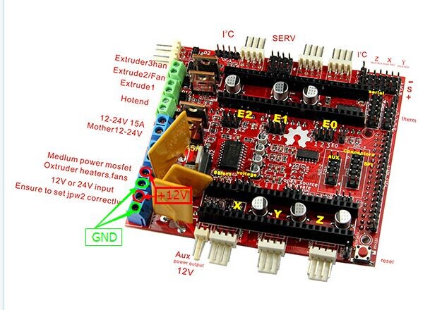

Could you please connect the Ramps-FD according to the following photo?
And upload the firmware I attach, to make the stepper motor work normal.
Please remeber that you have no need connect Ramps-FD when you uploading the firmware.
After you finish tested, please tell me the results.
Waiting your reply. Best regards.

Re: RAMPS-FD
Posted: Tue Jul 22, 2014 10:38 am
by Lemon
Dear friend,
JP1 VIN and JP101 VLOG need plug jumper caps.
I attach the pictures.
Best regards.
