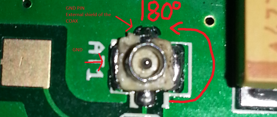

Recently I bought one of your GSM shield, but it had a defect. When plugged, I could send AT commands to the module and communicate with the SIM900, but I could not get connected to an operator. The signal was very weak. I tried different Sim Card and operators, but it could never get connected. After testing the conductivity of the antenna circuit, I found that the small surface mount antenna connector was solder incorrectly. It was reversed and the ground was now linked to the sim900 antenna output pin. I soldered it back on the right side, but the damage were already made. Because it was soldered to the ground, the antenna output made a short-circuit and broke the sim900 antenna output. I really needed this module for a project... Do you have a solution for me?

Sorry for this delayed answer. I was away for a while. Here's a picture of the repair I made. Has you can see, I rotated the connector 180 degree. When I received the board, the external shield of the coax pin (that is now on top of the picture) was connected to the signal trace. Because the side of this connector are also connected to the ground, it had put the signal trace to the ground and damaged the antenna output.
In this picture, the signal trace is now connected to the center of the coax connector.

Wow! What a patch work.
Mine still isn't able to get register with my SIMCard. I tried with a friend who also bought a SIM900 shield, but from another compagny. He was able to get connected to a network with my board, but he had a very bad signal strength compare to his board that wasn't damage from the short. I still suspect that this mistake damage the antenna output.
I'll just have to write this review on EBAY. Both of us had defect boards....
