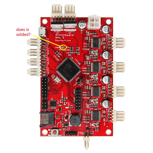

Re: USB Cable Connected, no Red LED. Not Connecting to Compu
sorry this boring you,do you ever plug the 12 power on the board?
PLS check the point is soldered。
No, I did not plug in the 12vdc.
Yes, the USB is soldered.
Yes, 2 small lines of solder.
Same as the Picture.

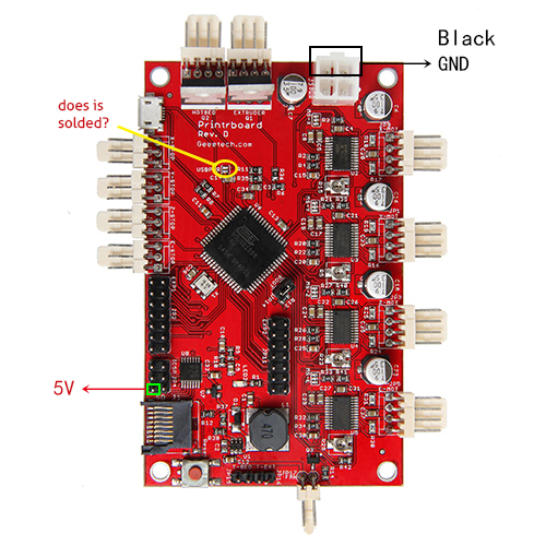

1.you shold set the multimeter like that
2.make sure that +5( red Probe)v is not short with gnd(black Probe )
Yes, from the 5 volt pin (shown in picture) to 12v (atc plug) ground is shorted.
i think if you don't pulg 12v power on,there are some short circuits in D1/C1/C12/C20/C25/C30。you can remove it one by one ,then test that does there has short between +5v and gnd

Previous Test:
I am testing with NO USB power and No 12vdc Power
I tested the 5 volt pin (shown in picture) to 12v (atx plug) ground, this is shorted.
I have never put 12vdc to this board yet.
I have only plugged in the USB cable.
Using that Electric iron welding diode D1 and Capacitance C1/C12/C20/C25/C30 down.
