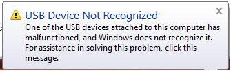

I purchased the "new version printrboard" and cannot get it to work. The board is recognized by the computer as a serial device when plugged in by usb ONLY if the power supply is left disconnected. If the power supply is connected, the computer gives an error message that the usb device is not recognized and has malfunctioned. Obviously I can't use the board without it being connected to a power supply. I have tried all of the different usb ports on my computer. I have checked all of the power supply connections. I have tried connecting the power supply first, then connecting the usb. The board always malfunctions when plugged into the power supply. There is no problem with the power supply as I have tested the output and I have used this power supply with other 3D printers. I have attached a picture of the error message I receive.

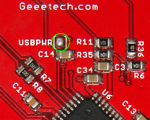

you can solder this pad,make sure it is not connected。Then you can change other usb com,and try it again

I de-soldered that connection and made sure it was no longer connected. Now when plugged into the usb and the power supply, the board is not recognized by the computer. I receive no error message and my mouse and keyboard become disabled until i disconnect the board from the computer. Because this was a defective board when I received it, I would like a new board or a refund.
