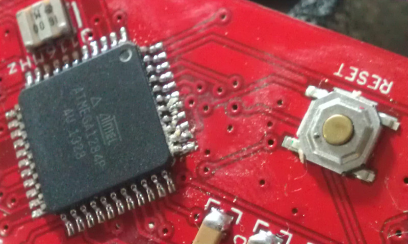

Similar issue here: I have two brand new geetech melzi ardentissimo with the ftdi chip. Linux reports the PID of 0000. There was a nasty bloob of weld shorting
some contacts of the ftdi chip. So I think that both boards are toast now...
- IMAG0976_small.jpg (108.73 KiB) Viewed 13980 times
