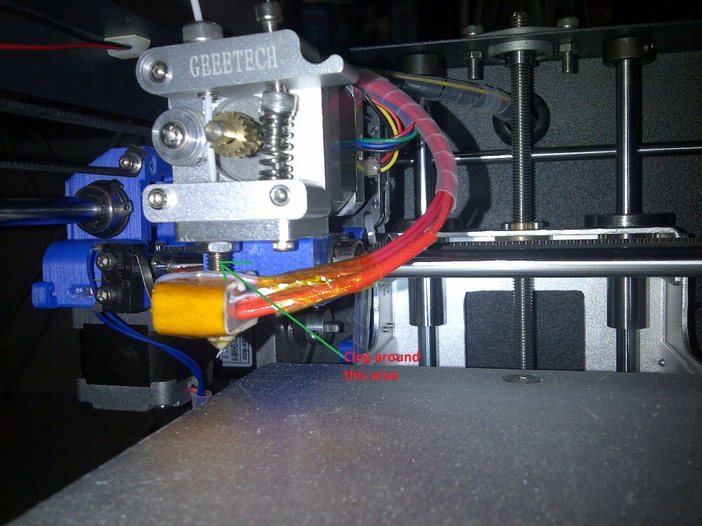

Hi, your suggestions could not solve the problem. The filament will melt at the upper part of the extruder, instead of at the tip of the extruder, cause the extruder get clog from second layer of print. I have heard that other customers also encounter same problems. Please advise. I am wondering any unit of MeCreator delivered actually works?
Re: Me Creator cannot move to X+, Y+, Z+
Could you send a picture about your problem, many reason may result a jamming, so we want to know more about yours.
Hi John, please see attached picture the area where the melt filament clog the extruder.
I think the clogging happen due to the design of the extruder, i.e. there is no heatsink to dissipate heat when the heat from the heater travel up to the upper part of the extruder.
Hopefully you can give some good advice.
Thanks.
Thanks.
