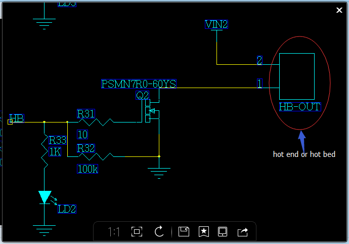

We can conclude that the circuit is normal, because you can see the temprature is raising.
Look at the picture
Please heat the heat bed and hot end (They have the same circuit construction) first in the repetier, and test the volt between "1" and GND, and "2" and GND, if they have the same volt, we can conclude that the mosfet is broken. Remember, "1" does not equal GND.
