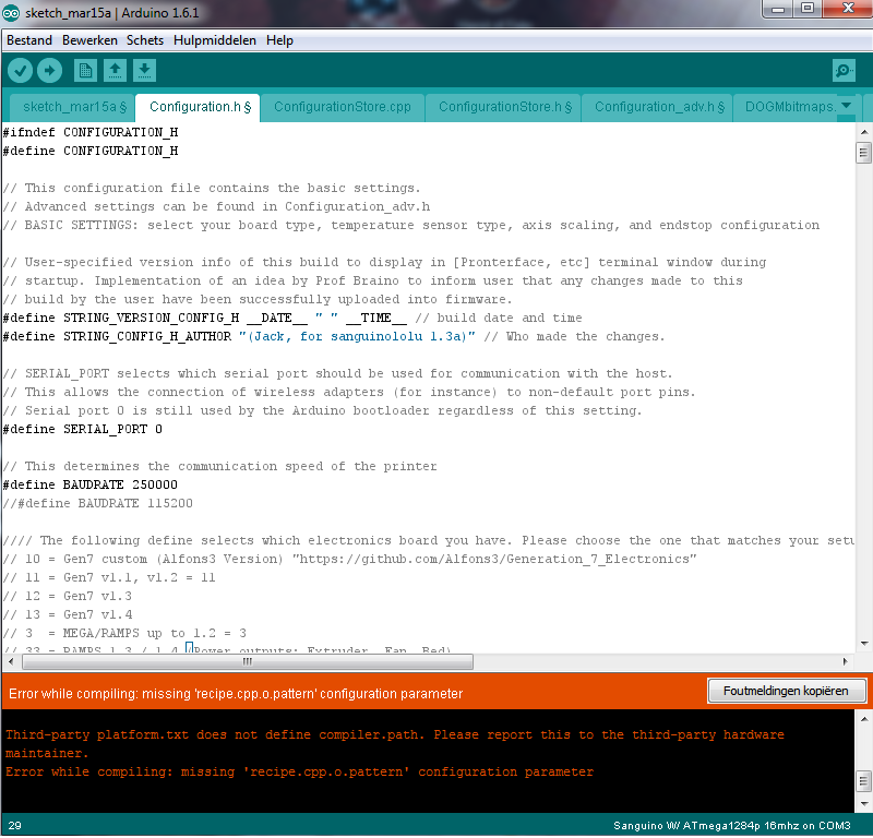

Now, when i try to compile the sketches, I get the following error:
'"Error while compiling: missing 'recipe.cpp.o.pattern' configuration parameter"
I attached a screenshot off the error, please take a look at it.

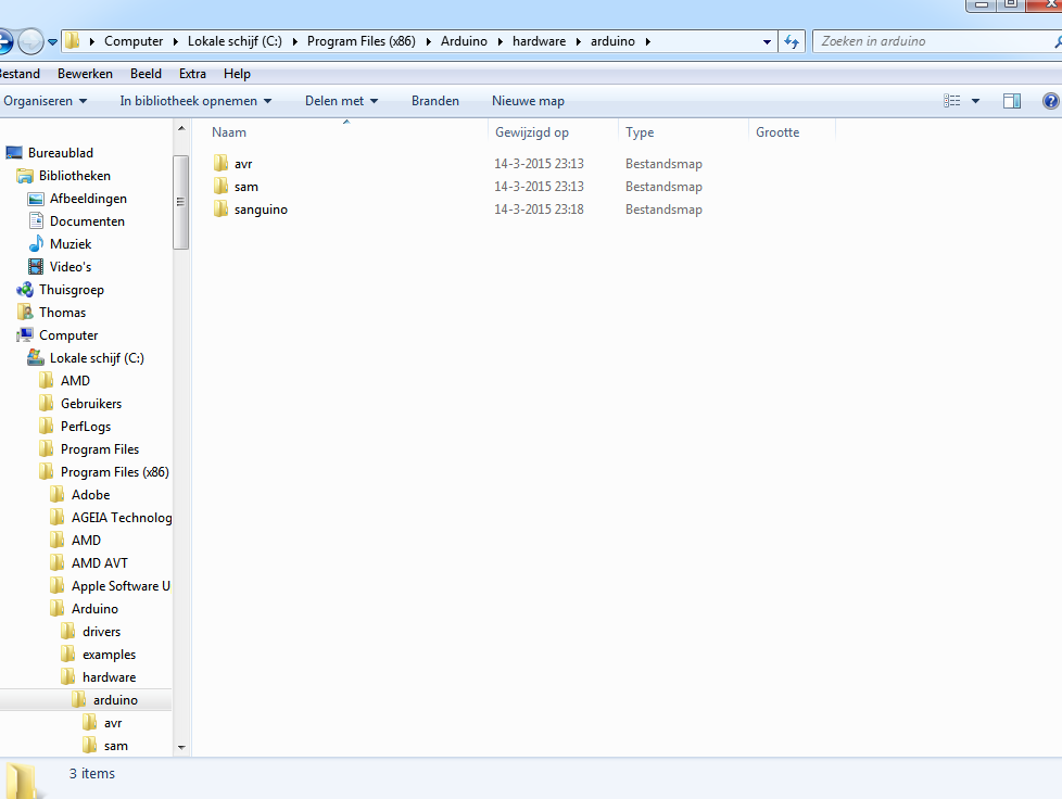

Can anyone tell me how to fix this code? I suspect its the bootloader (which i pasted in the C:\Program Files (x86)\Arduino\hardware\arduino map, see the second attachment for this).

Re: Problems compiling firmware with arduino
Did you select all the files and drag them into Arduino IDE? If you did so, please leave your email address, I will re-send you the firmware to see how it will be.
Hello,
By now I found a solution to the problem.
A friend gave me an earlier version of Marlin firmware, and showed me how to add the bootloader to the IDE in the proper way, since this wasnt described very clearly on the wiki.
But thanks for your time.
