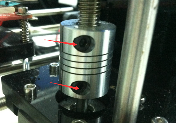

Maybe you have not tightened the couplings. Please tighten them.
Rotate the screws as shown in the pictures:

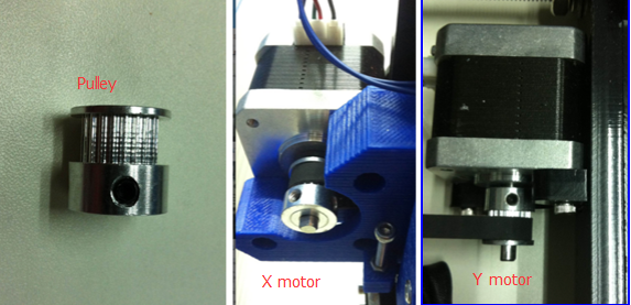

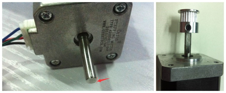

Firstly, you should make sure the assemble direction of pulley is correct. Look at the picture below:
Secondly, as you can see in the picture, the section of the shaft of the motor is not circle, there is a flat side. So you should correcly assemble it to the pulley(Look at the hole of pulley carefully). One screw on the pulley should be aligned the flat side. Tighten all the screws. Hope will help you.

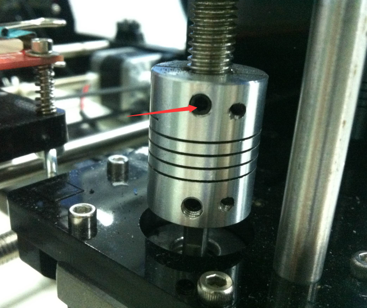

Hi, Dominique
Vous ne avez pas besoin de résoudre le problème de l'aluminium. Vous pouvez voir la flèche dans le dessin-il? Serrez les trois vis.
Je espère que vous pouvez résoudre le problème.
Je utilise la traduction de Google. Je espère que vous pouvez comprendre.
bonne chance.

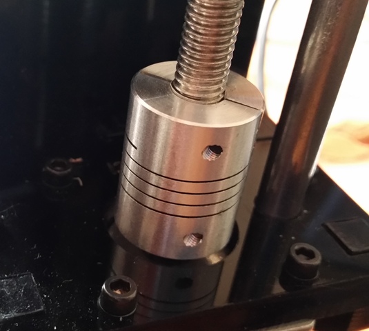

Re: Assemble the X-Z axis Problem
Hello,
there is not screews on the back
Dominique
Dominique
