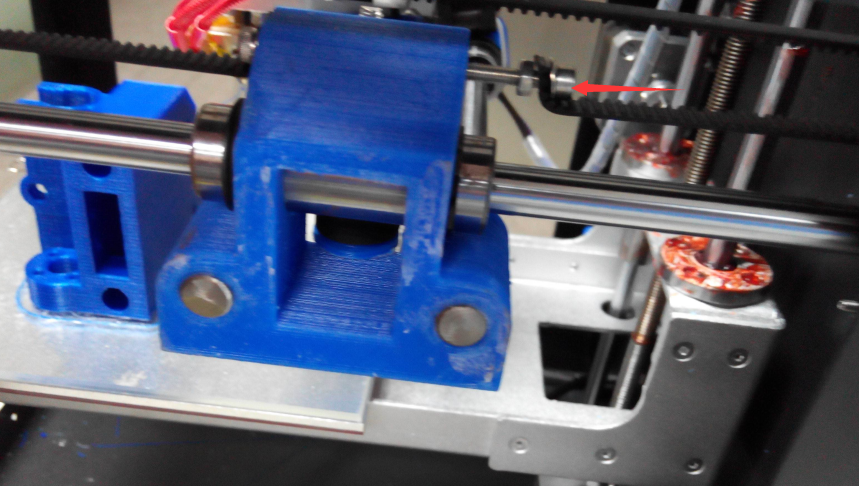

At about 100 layers on a print, my printer skews on the x axis. One recommendation was to tighten the x axis belt, and compared with the 2 y axis ones, it feels looser. Problem, I can't figure out how to, and the FAQ/Wiki is no help.

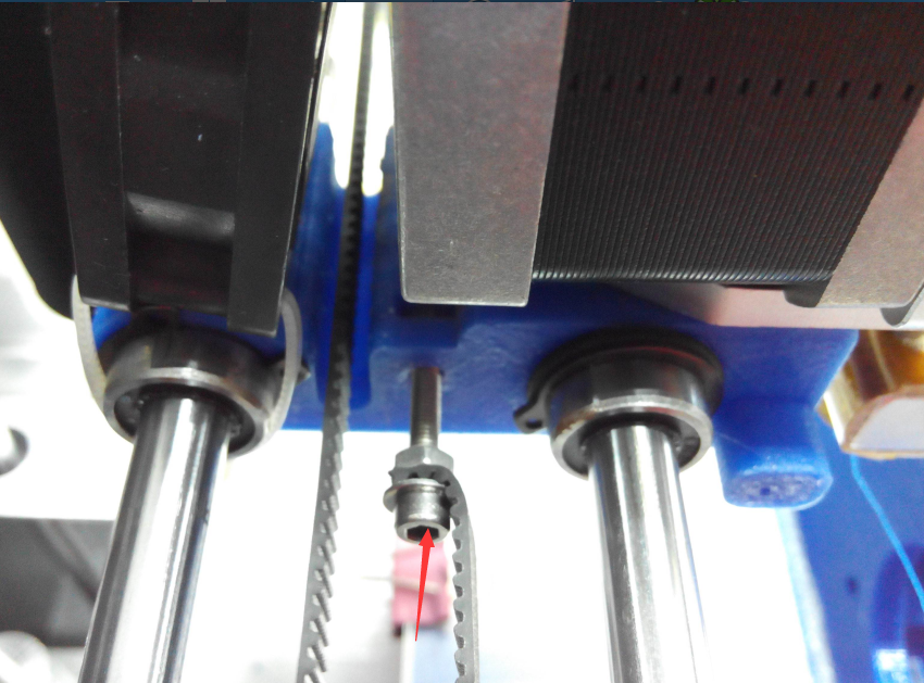

Please ratate the screws ,which the arrows point to in the picutrue, you can tighen or loosen the belt.

Thank you for the confirmation (and the pictures!)
I'd seen that and had though it must be what needed adjustment, but when i tried to gently turn it, it wouldn't move. I wasn't applying enough pressure apparently (i didn't want to break this).
Thanks again for your help.
